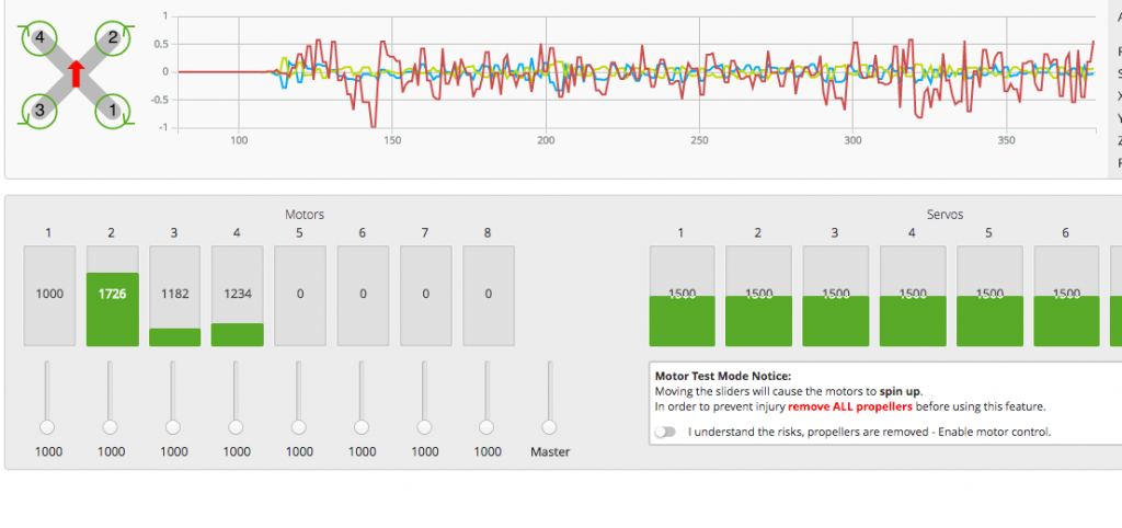

Now, please check screen attached here. I have a very strange behaviour.
I wanted to make a first test, props off of course, with the remote and the motors do not act like they should be.
If i move the slider in Cleanflight, they are all equal and working at the exact same rate etc., like it should be. (and they stay like this)
With the remote, they seem to do what they want even if i throttle up just a little bit, motor 2, goes higher and higher while motor 1 not even spinning.
If i throttle full, from zero, not all motors are at highest point.
So, throttle up over the FC with Cleanflight, all looks good, throttle up over the remote, chaos.

Did you start with a new model in your radio? Did you check your radio setting in CF making sure the range of travel for each change is correct?
TheCrey
Hi,
yes it is a new model.
The Range are good, from around 990 to 1945.
This is for all sticks, and all switches.
With an older, test FPV, it was working fine like this.
Even with the same FC is used.
Regards
TheCrey
TheCrey
Just FYI, if someone is reading this or will have the same issue.
I just reflashed the FC, and now all is working fine, i still do not know what happened here, but it is solved.
