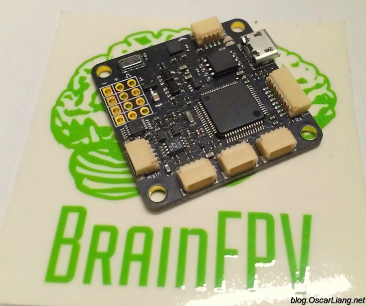

Just came across this while surfing the interweb, same 30.5mm mounting hole format as CC3D/NAZE32 (and derivatives) but with the OSD functions built in!
This is a big step forward for smaller heli's as the OSD can be SOL when it comes to mounting space on increasingly smaller frames. The firmware is related to the TauLabs product so @peabody124 may like to chime in and share what he knows about it.

The Brain gives the user a lot of freedom in terms of hardware connectivity and the ports can be configured through the ground control software (GCS) to assume different functions. The following diagram lists all ports and their functions. More detailed information about each port is given below.
AV Port Video input and output for OSD, audio output.
Flx Port Serial port (UART) for GPS, telemetry, serial RC receiver connection (Spektrum DSM2/DSMX, Graupner HoTT), etc. The Flx Port can also be configured as I2C, which allows connecting an external HMC5883 compass.
Main Port Serial port (UART) for GPS, telemetry, RC serial receiver connection (Spektrum DSM2/DSMX, Graupner HoTT), etc. This port also features a hardware inverter for connecting Futaba S.Bus compatible RC receivers.
Rx Port Main RC receiver port for PWM/PPM receivers. When PPM is used, only a single pin is used for the RC input, which allows using the other pins as PWM outputs or as an additional serial port for GPS, telemetry, etc. It is also possible to configure the port as PWM output only, giving the Brain a total of 10 PWM outputs. Finally, an additional serial port (UART) can be enabled on the RxPort, which allows you to connect even more gadgets to the Brain!
Sen Port This port is for analog sensors with a voltage range of 0V - 3.3V. Currently supported are voltage sensors, current sensors, airspeed sensors, and RSSI (received signal strength indication).
Servo Port Main RC motor/servo output with 4 PWM outputs (up to 400Hz). It is recommended to power the Brain through this port (max. voltage 6V).
SWD Port
Port for software development and debugging using an ST-LINK/V2.
USB Port Micro USB port for configuring the Brain trhough the ground control software.
