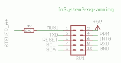

Getting an avr mkii in the next day or so, can you tell me how to make the adapter
Please
On the wiki, there are some pics of people using card edge connectors or even just 10 pin connectors that are wedged onto solder blobs on the pads. Two servo extension will work if you rewire them.
Below is the MK II pinout and the BL-Ctrl pinout. Just match up the wires and make sure you get pin 1 right on both ends. Look for the '1' on the BLC and the arrow on the MKII.
You will need to power the board - the programmer won't do it.
