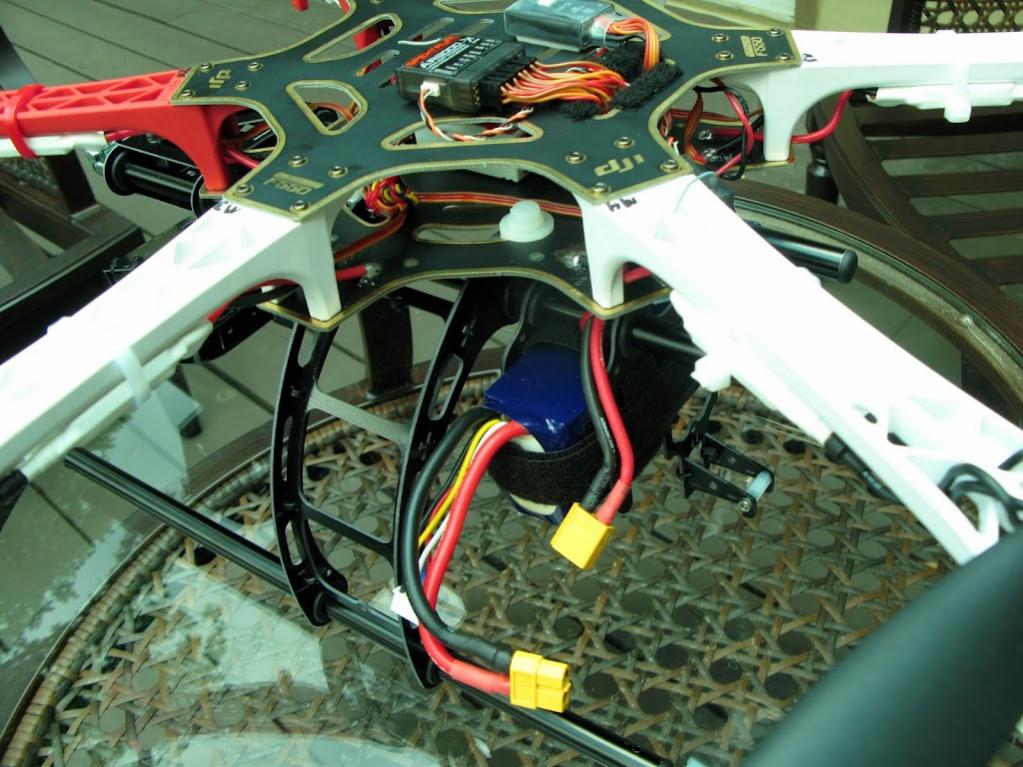

chipwich
I use three pieces of Velcro, which came with the aeroXcraft landing gear. I cut one of the two pieces in half and use them vertically at each side of the battery, and take the last longer piece and wrap horizontally around the ends. The piece that wraps laterally also sticks to the vertical pieces and the whole thing is pretty snug. Don't know if it was meant to be that way, but works for me. Hope you can see in the photo.
