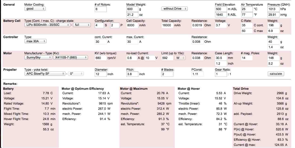

It it really depends on the big picture. You need to provide more details of your build (frame, ESCs etc) for people to give you a good suggestion. It also depends on what you plan to do with it - aerial photo/video will surely require more lift-payload capability, which would help determine your needs for the motor.
Also, don't be afraid to head over to eCalc and plug in some numbers. It definitely helps show you the ballpark performance of what different options provide.

It's really a matter of getting some calculations going in eCalc. You need to plug in your specific components, and start swapping around to see what works best for you. That should help get you going in the right direction.
When you say you want more "power," you mean lifting/payload capability?
It's also good to check out other people's successful builds that are similar to your gear and goals.
@motopreserve wow, Thank you, I never seen this e calc work sheet.. I just ran some numbers and will continue to throw some numbers at it.....Thank You ! and Yes Im looking for More Payload..

It definitely helps you get in the ballpark.
Keep plugging numbers and swapping components - it will help get you close.
