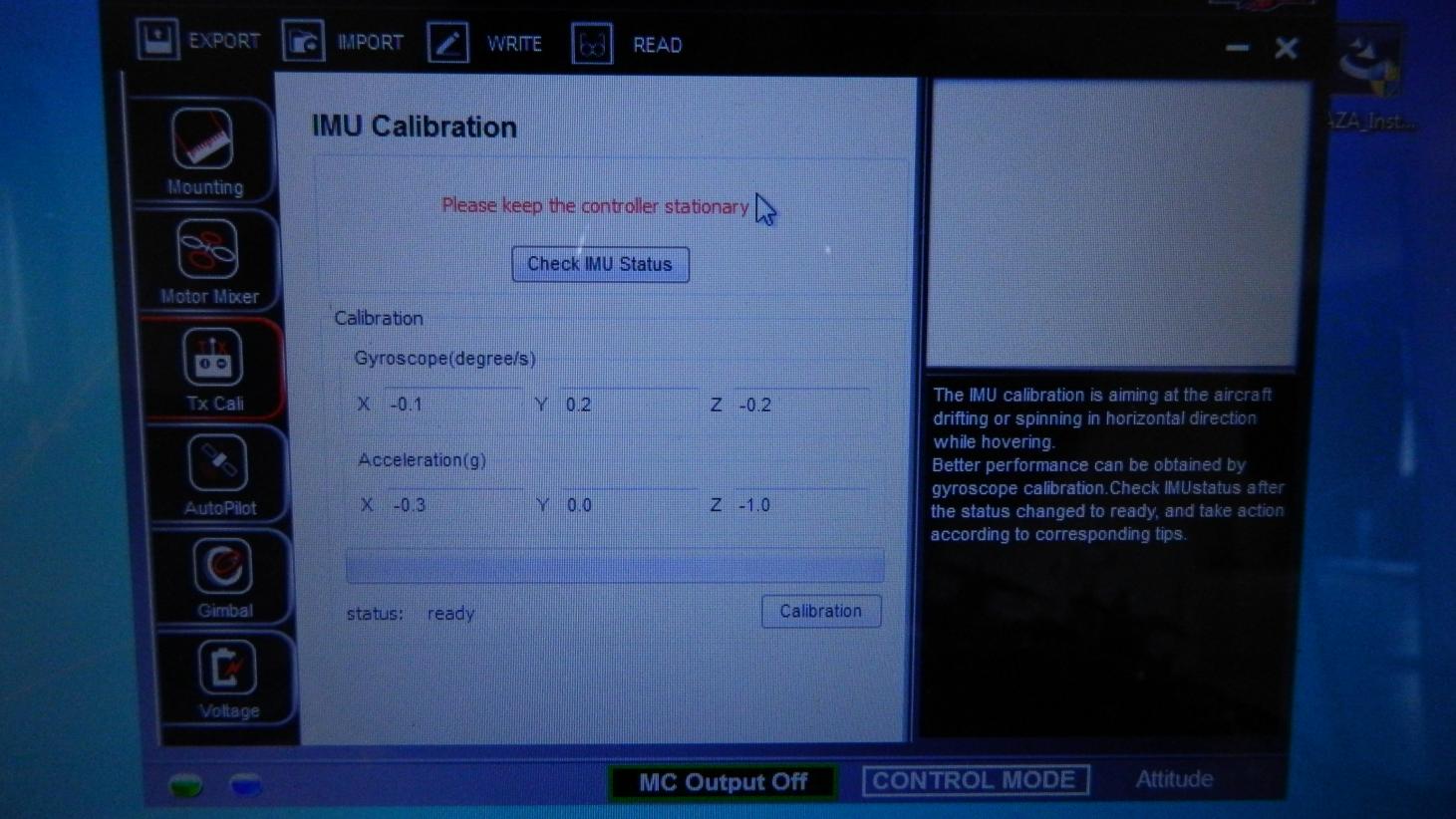

I switched motor 2 with motor 4s ESCs and that made no difference the F450 still fly's backwards. I wish someone did live near me so I could try a different Naza. I did a IMU recalibration with 6 xbox game cases under the rear arms IE: 3.5" raised and that made no difference, how much do you guys raise the side that drifts for IMU?
To summarize I have swapped motors, ESCs, RX and TX(dx6i to t8fg) props, battery's removed GPS, fpv gear/camera and legs. All that's left is Naza, VU, usb cable and assistant software, am I missing something?
Edit. Now useing cellphone cable and have reinstalled assistant software. no change still flys backwards FAST

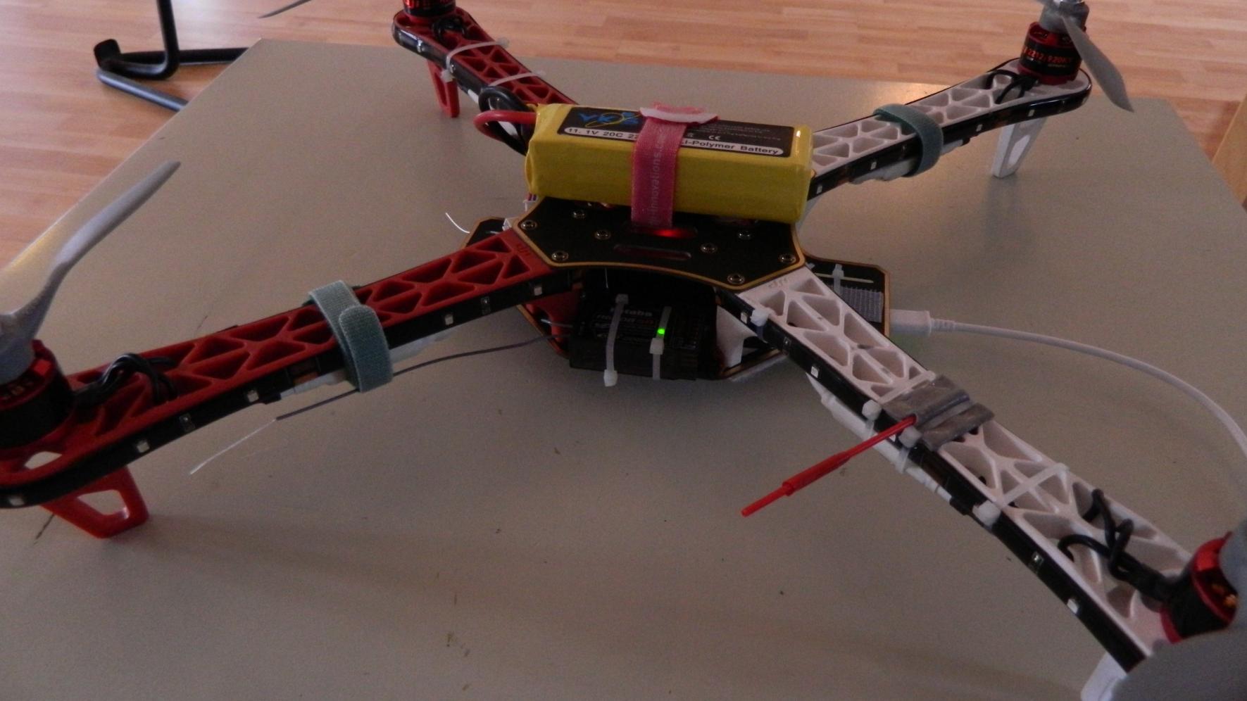

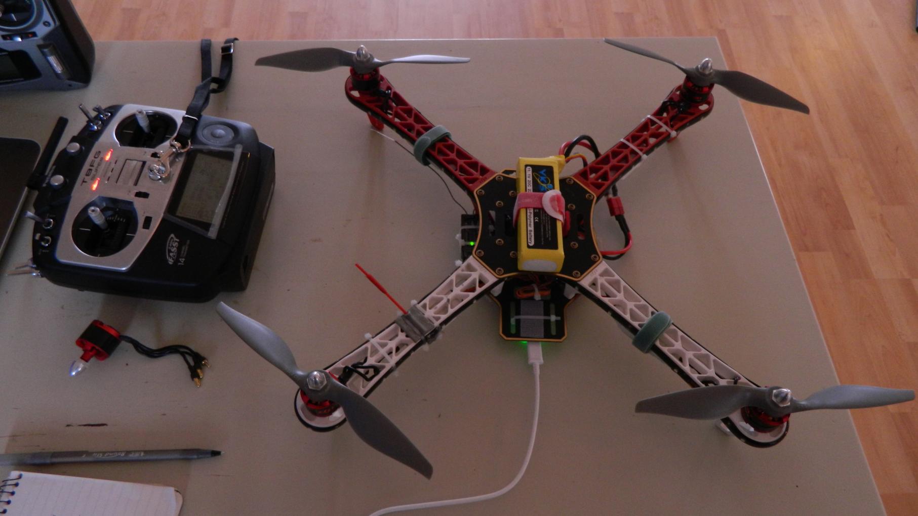

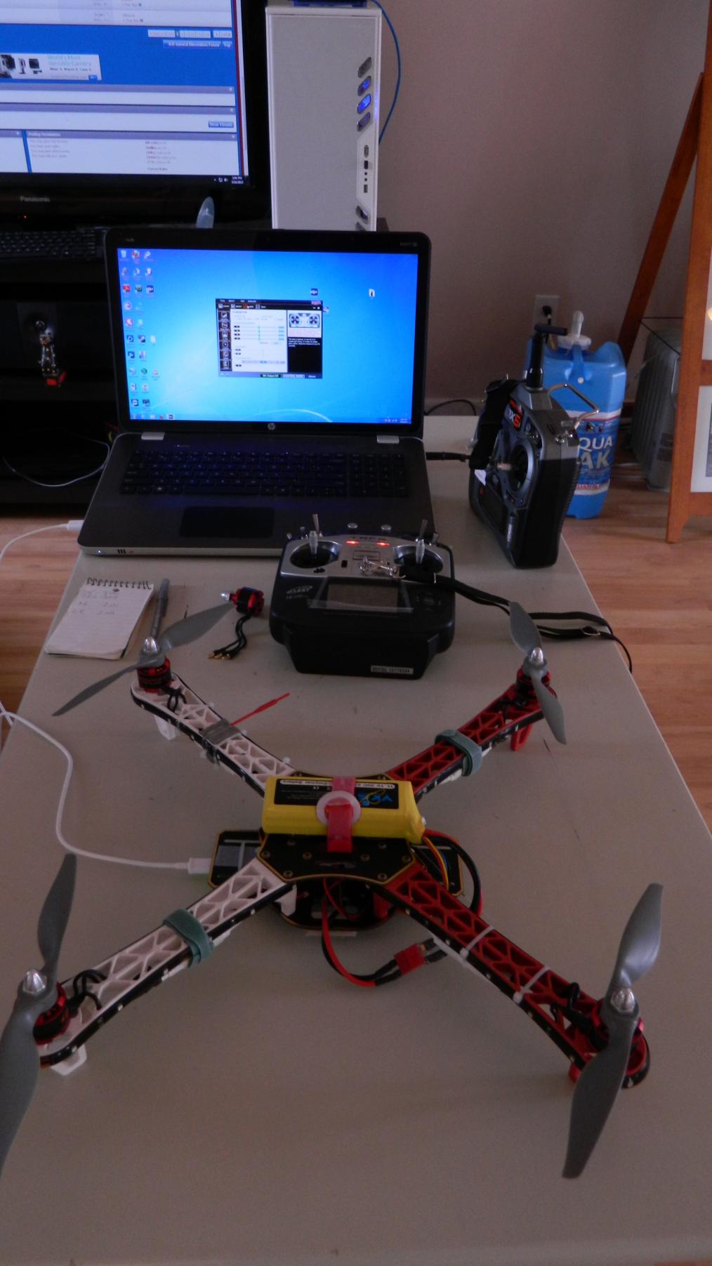

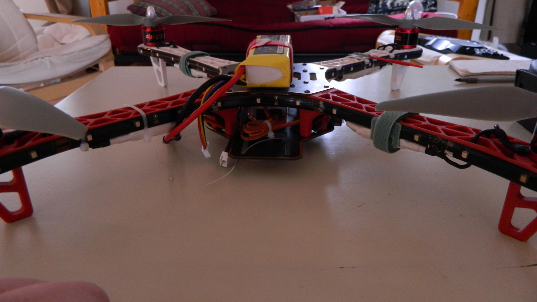

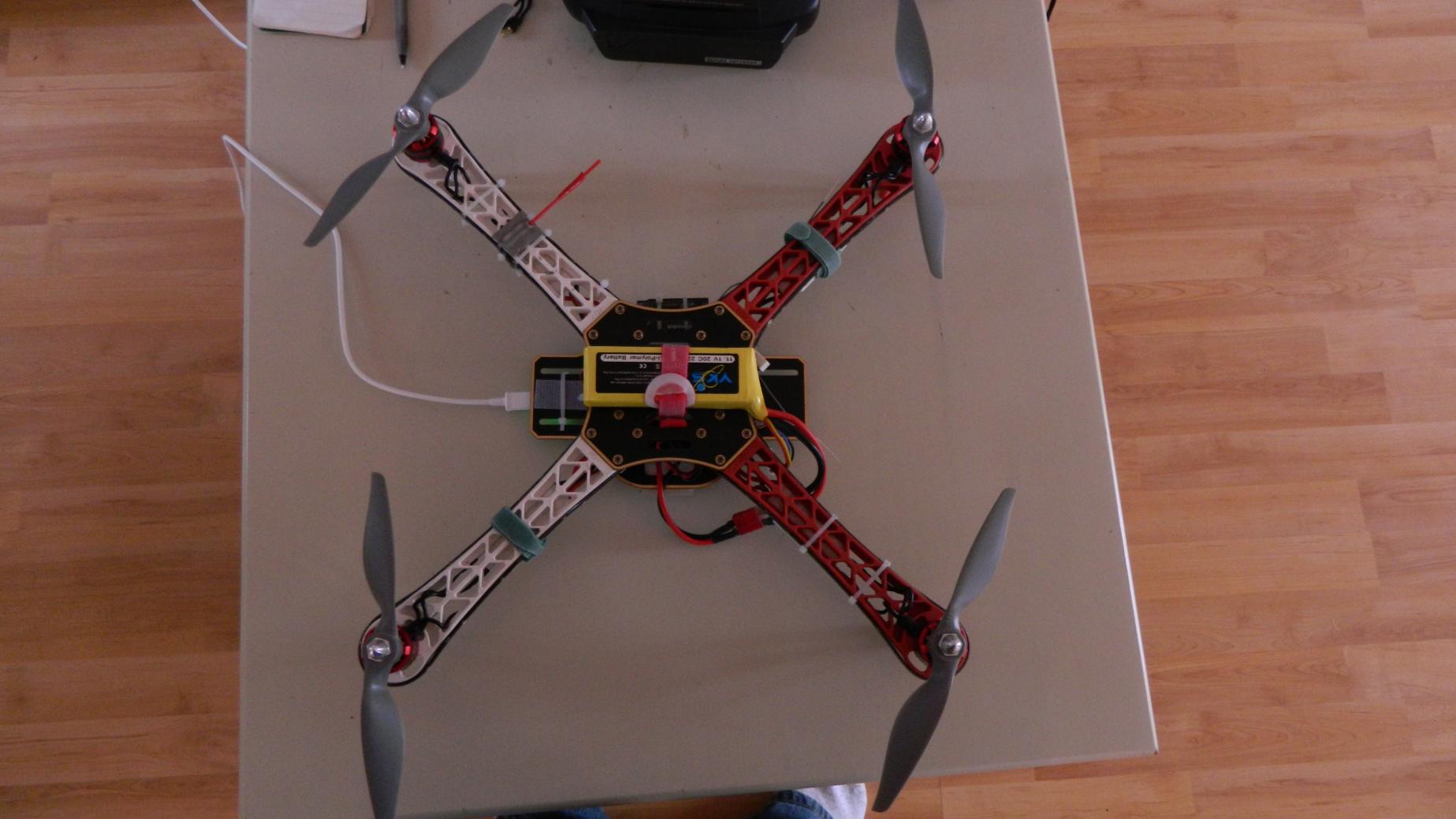

Try posting pictures of your set up. Maybe it can be obviously seen why it drifts to someone else. take all the diffent angles.
Fxt4me

Fxt4me

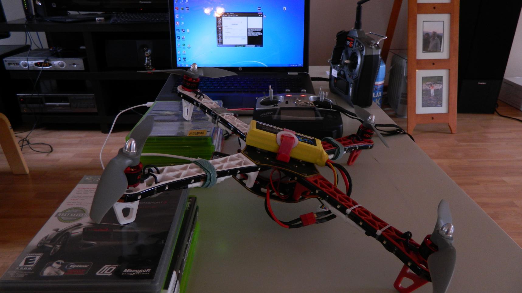

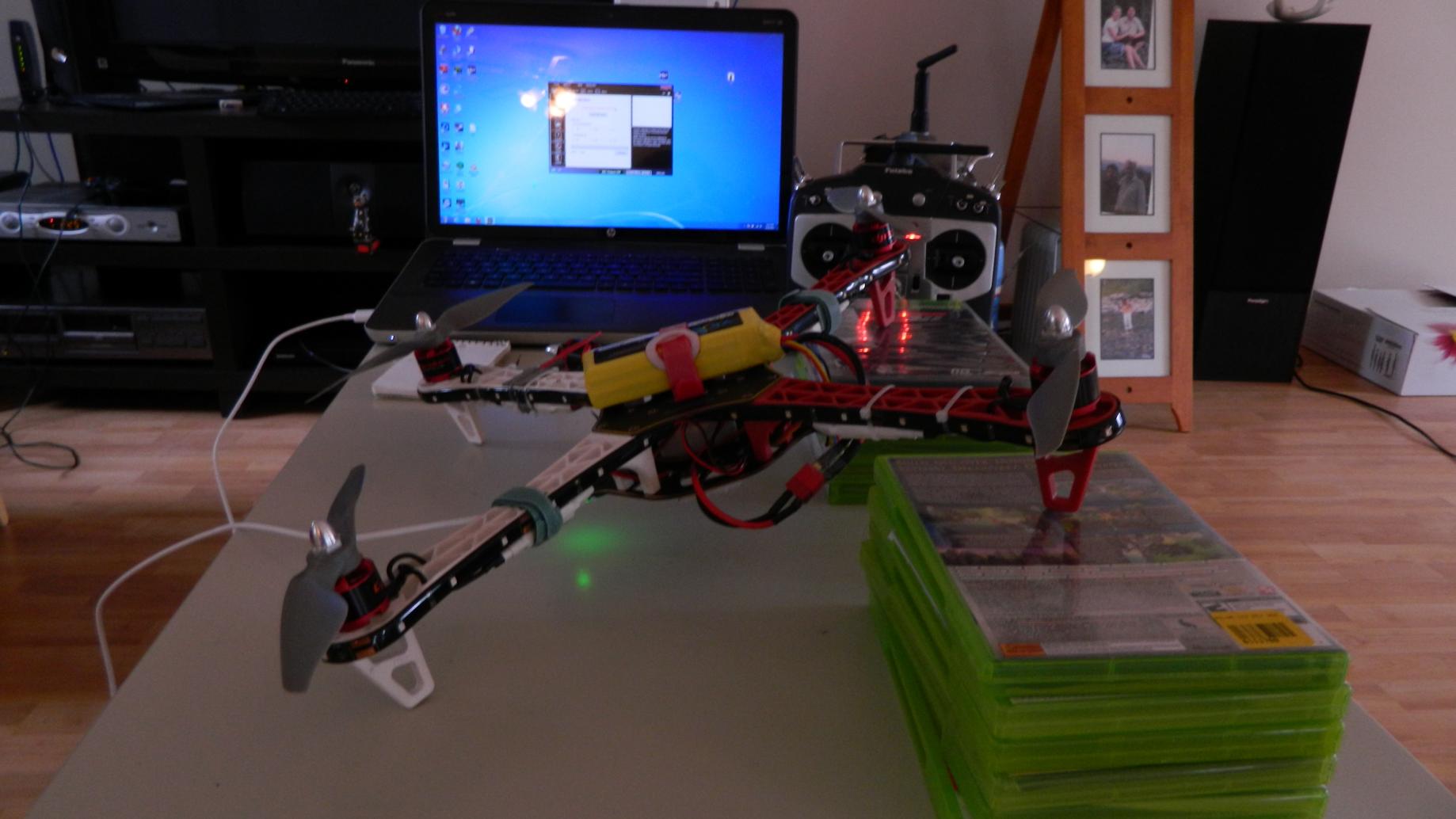

Here are some pics of the many IMU calibrations(this is the most extreme) I have done over the last few days, both front and rear have been raised as much as 3.5" and I could not tell any difference in flight. The F450 always wants to fly backwards and somewhat to the right.
View attachment 10289View attachment 10290View attachment 10291
