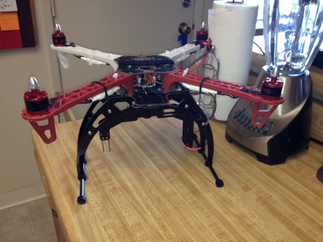

As for attaching the landing gear, you're right, the instructions don't quite match up, which was part of my headache. From what I was able to figure out, the landing gear has two "t" shaped slots on either side of it. You insert one of the plastic nuts into each slot and then mount the larger of the mounting plates to those nuts. Then I plopped the copter on top of that with some double sided foam tape for extra stick and screwed the two smaller plates through the slots in the F450 board into the X468 mounting plate. To be honest, I had to do a lot of sanding, a bit of drilling, and a lot of internal cussing. The design of the "t" slot doesn't seem too sturdy and I'm not sure how well it will hold any weight. I haven't had the guts to throw a camera on it yet but might give it a try if I'm really in a bind. Otherwise, I'll just wait for the real camera mount to come in and chalk up the rest to a somewhat expensive learning experience.View attachment 4238
