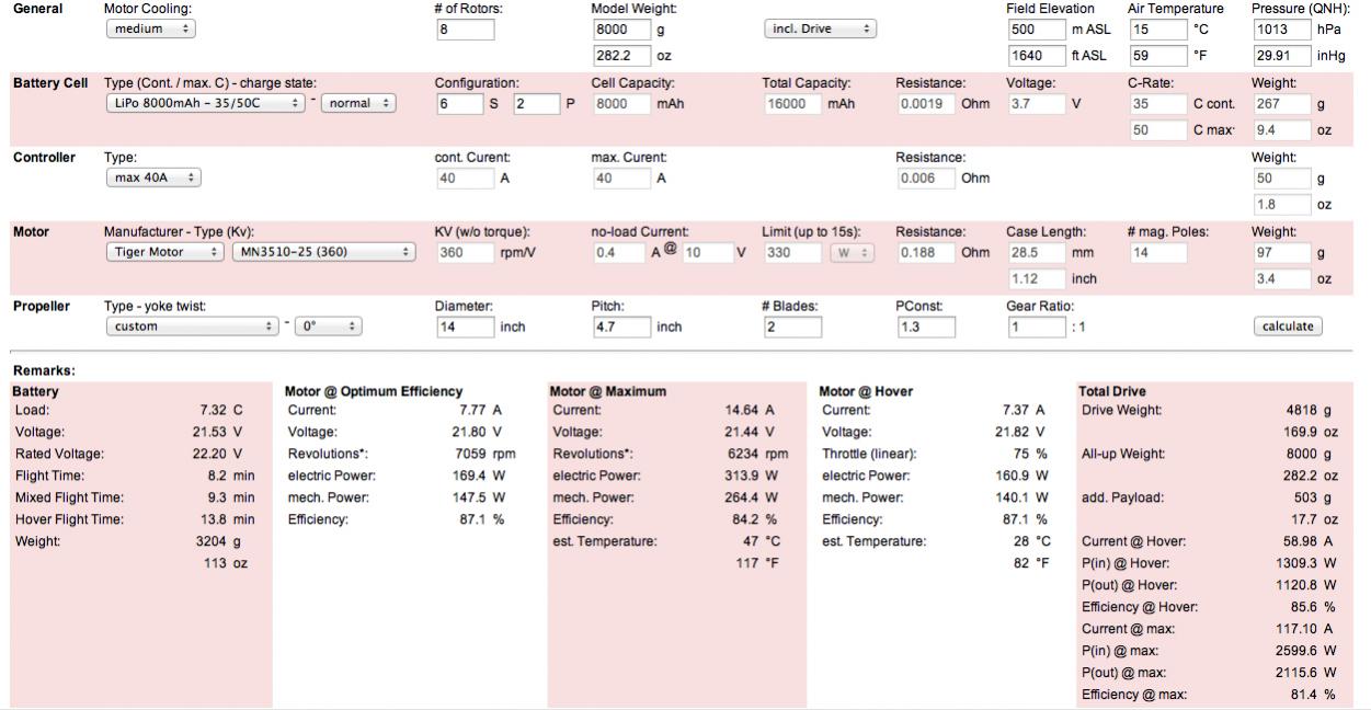

One more thing I'm confused about here. I've spent weeks researching and fiddling about with ecalc and have finally come up with a reasonable calculation based on the Tiger Motor MN3510-25. Everything seems fine on ecalc but when doing manual calculations the motor rating doesn't match very well with the battery selection.
Am I missing something here? (see the picture)
The MN350 is rated at 15A continuous, which seems a little odd.

You need bigger props or a higher KV motor for safe hovering. I would recommend to go with MN4012-400KV for that AUW.
