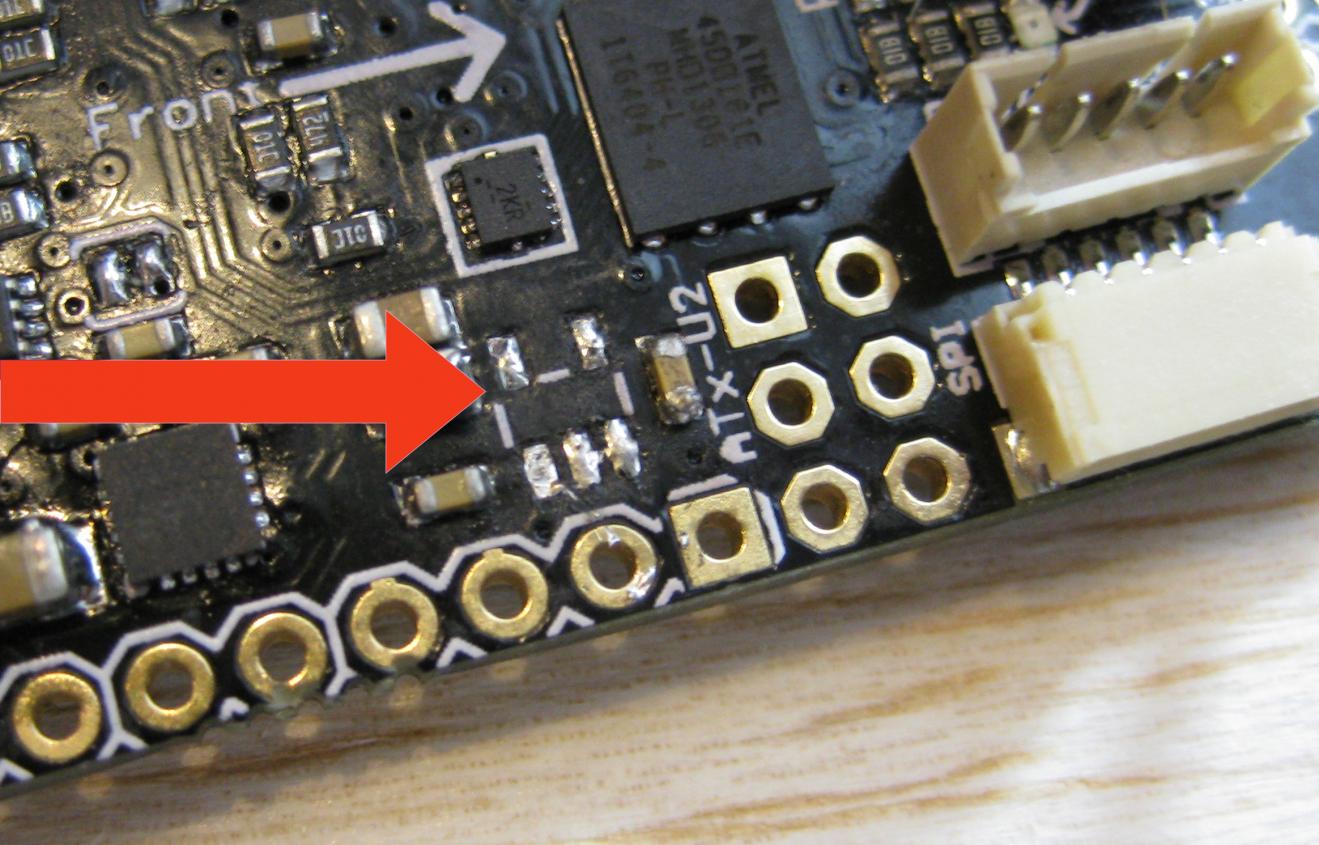

I got the dreaded "Bad Gyro Health" message with my Hobby Works HK v2.5. My first mistake was buying the HobbyKing board. These things are junk. Terrible solder joints, bad lamination....junk. I should have spent the extra couple of bucks and got the board from 3DR. I haven't even flown the craft yet, and the second time I plugged it in, I got the message on the Mission Planner.
After some research, It turns out that the latest firmware can smoke one of the voltage regulators, or the regulator was defective to begin with and the firmware is now "noticing" it. This seems to be happening mostly on clone boards. When the regulator fails, you will have a full 5 volts running your sensors instead of the regulated 3.3 volts.
According to the 3DR website, your only options are to send the board back or replace the regulator. Since this is a HobbyKing product, I don't think it is worth trying to deal with their customer service...
The good news is these tiny regulators are only about $1.50 from Digi-Key
http://www.digikey.com/product-detail/en/TPS79133DBVR/296-11866-1-ND/381441

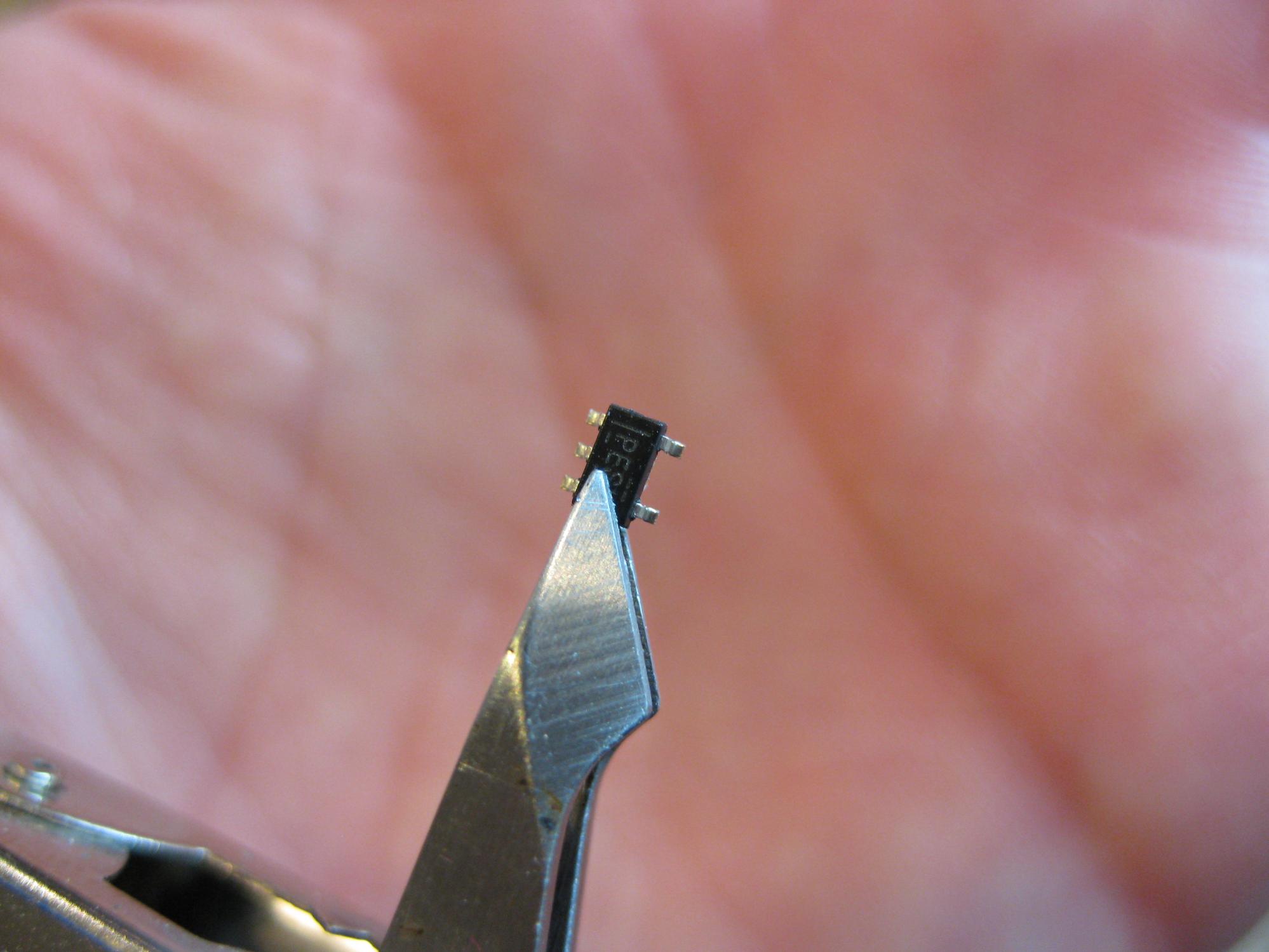

I was able to fairly easily get the old one off with a small Radio Shack soldering iron. I should be getting the new regulator in the mail in a day or two, so I will follow up if I can successfully get it back on the board. View attachment 15450View attachment 15451
I'm curious to see if the voltage regulator on the HobbyKing board was the correct Texas Instruments regulator, or some kind of China copy.

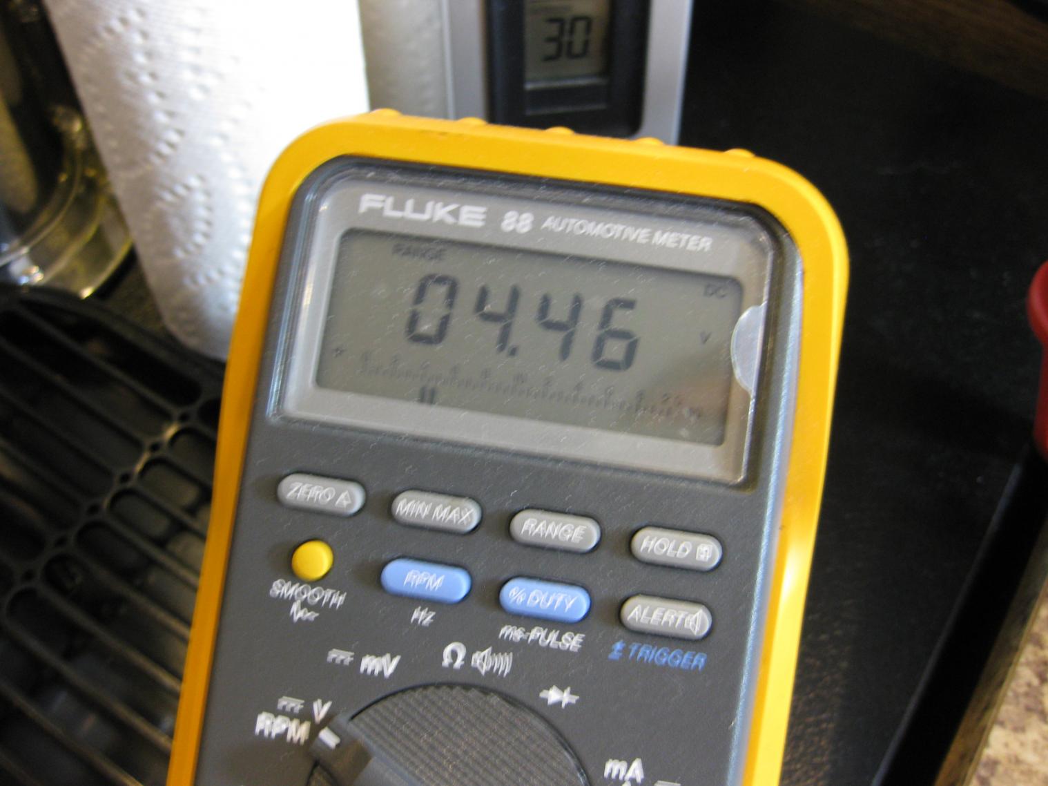

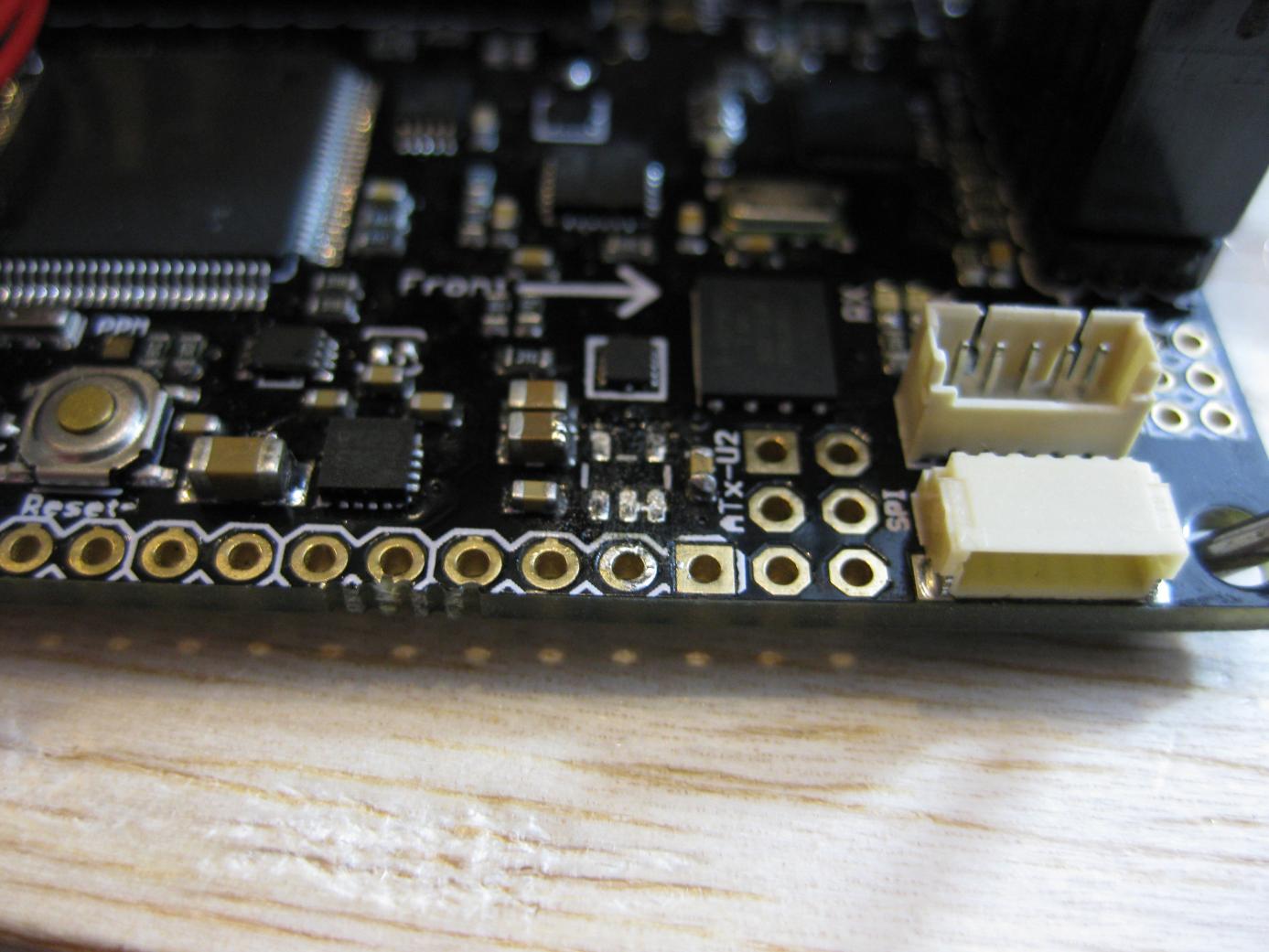

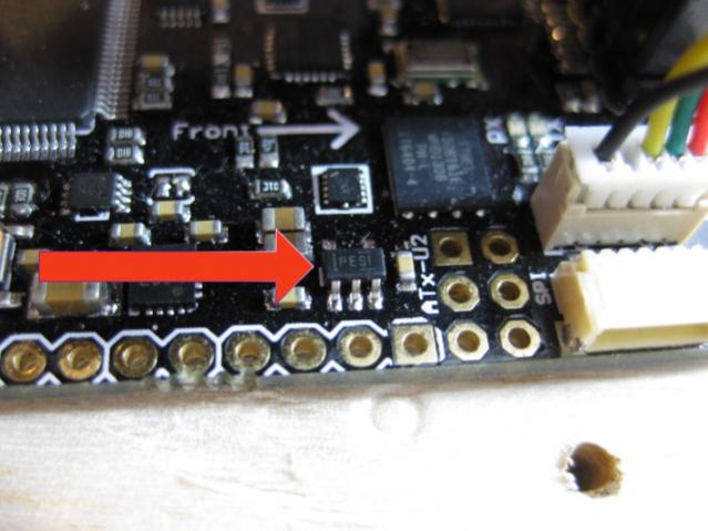

Now I'm frustrated. I got 4 new 3.3v regulators from Digi-Key today. Soldered one on and checked the voltage. 4.4v?, Tried a second one, 4.4v? Tried a 3rd one 4.4v??. I then checked the voltage without the regulator installed 4.8v. I tried running Mission planner with the 4.4v and the "Bad Gyro Health" message still comes on after a few minutes. Any ideas?View attachment 15492View attachment 15493View attachment 15494View attachment 15495
My soldering may not be the best, but its seems like it should work. I guess I can try to test my last voltage regulator with 5v and see if it steps it down to 3.3v before I solder it on the board.View attachment 15496

i wouldn't bother trying another one. call digi-key tomorrow and talk to a tech assistance rep. they're very helpful and may be able to explain what's going on. it may not be the voltage regulator that is screwing things up, it may be a problem elsewhere. i don't have the chops or the patience to try to fix circuit boards so I generally throw them away before I can get the urge to make an attempt. i tried to fix a few Mikrokopter speed controllers but there's that fear that the thing that popped wasn't the problem so you're just on borrowed time until it pops again.
call digi-key and see what they have to say. you may have the wrong part #, even an incorrect prefix or suffix can screw things up with electronics parts as there are so many variations for a given size shape component.
Skywalker
Good point. I checked the data sheet for the regulator and there are 3 versions for fixed voltage. 1.8v, 3.3v, and 4.7v. Maybe They just sent me the wrong one.
Skywalker
I called Digi-Key, excellent customer service. I am going to check my remaining regulator off the board to see what the voltage is. Im hoping they just sent the wrong one. The markings on the case of the regulator are slightly different that the original one.
Skywalker
I'm throwing in the towel on this one. I tested my remaining regulator off the board, and it measured 1.99v(should be 3.3v) so that makes no sense. I checked the voltage on the pads of the board without the regulator installed, and I think this burned something else up. Now it wont work at all. Oh well. I should have just left it alone when I had 4.4 volts and used it on a cheap quad build or something. Looks like time to order a new one, and not from Hobby King!
