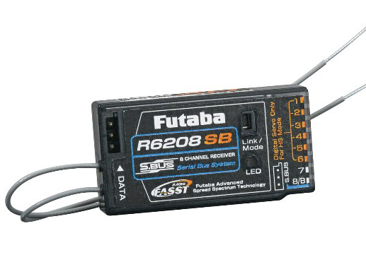

i am using 10CHG using R6208SB S-Bus Receiver.
at the moment i just hooked the normal way the A, E, T, and R and extra channel for the mode switching. so there is 5 cable all together ...

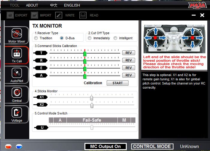

are there anyone using this s-bus connection ? what are setting need to be done from the assistant software v1.2 ? any good using this connection. please share with us.

three steps toptweaks. locate the s-bus port on the futaba receiver, find which port on the naza controller is dedicated to s-bus, in the config tool choose d-bus and you are set. Your Receiver also needs power either from one of the becs on the ESCs or from the PMU bec output.

Yes there are excellent manuals here: http://www.dji-innovations.com/products/naza-multi-rotor/downloads/
Start by completing the hardwire connections as per page 8 (DJI d.bus is equivalent to Futaba s.bus) don't look at ppm connections.

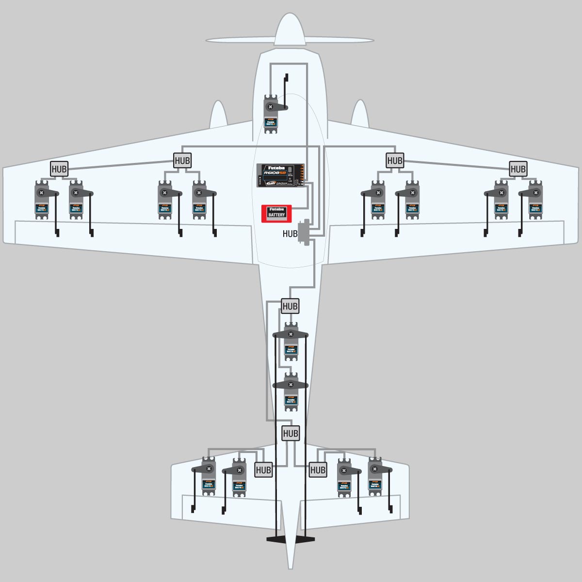

Short theory about S-Bus:
S-bus was invented by futaba to minimize the servo wiring in larger RC-Aircrafts.....the idea behind was to have only one data-stream (like in CAN-bus systems for cars) coming from the transmitter, where the signals are coded with "adresses", so only the servo with the matching adress would react. For a S-Bus system in RC aircrafts you would need 3 things: 1) S-Bus receiver 2) programmable S-bus servos 3) s-bus hubs...... see the picture:
The S-Bus system in connection with Naza or WooKong is more of a "work-around" to reduce wires between Naza and receiver.....but it's got a back-draw....you have to use the channels like stated in the manuals since in the Naza/Wookong you can't programm "adresses" like in S-Bus servos.....you have to take it as it is. For example: In Naza/Wookong throttle is on channel 3, so your transmitter has to use channel 3 for the throttle stick. In Futaba Tx's it's easy....when you set up a new model in the transmitter, the channels are set already in the right Naza/Wookong channel pattern (since it is a standard in all Futaba Transmitters when setting up a new model), but in other transmitter brands (HoTT, Spectrum, Aurora....) the channels must be set to comply with the Naza/Wookong channel pattern....no way to change that. I hope DJI will change that in the future.
Since this question comes up many times in connection with S-Bus: While S-Bus receivers are connected via S-Bus cable (normal servo cable) to Naza/Wookong, the "normal or traditional" servo connectors on the transmitter are a "mirror" of the S-Bus channels. If throttle is on channel 3 in S-Bus, than throttle is also on the "traditional" channel 3.....so it's not possible to have a "mixed channel" set-up
