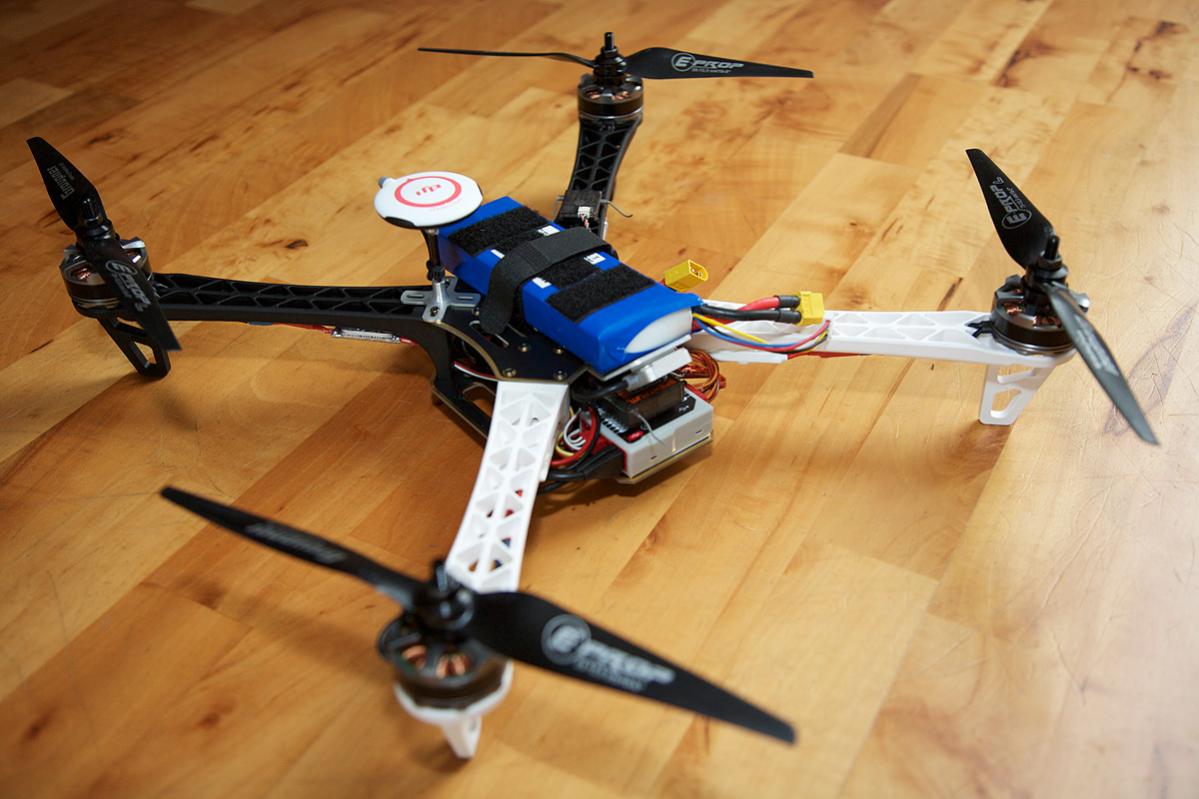

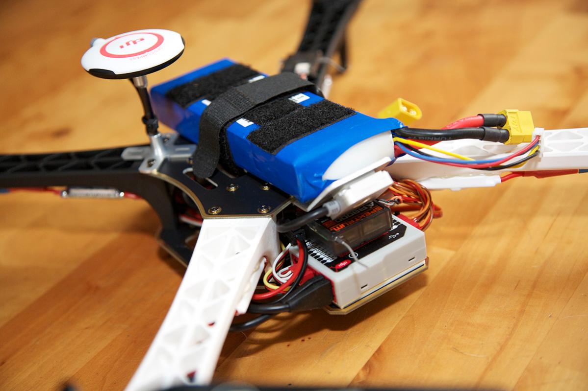

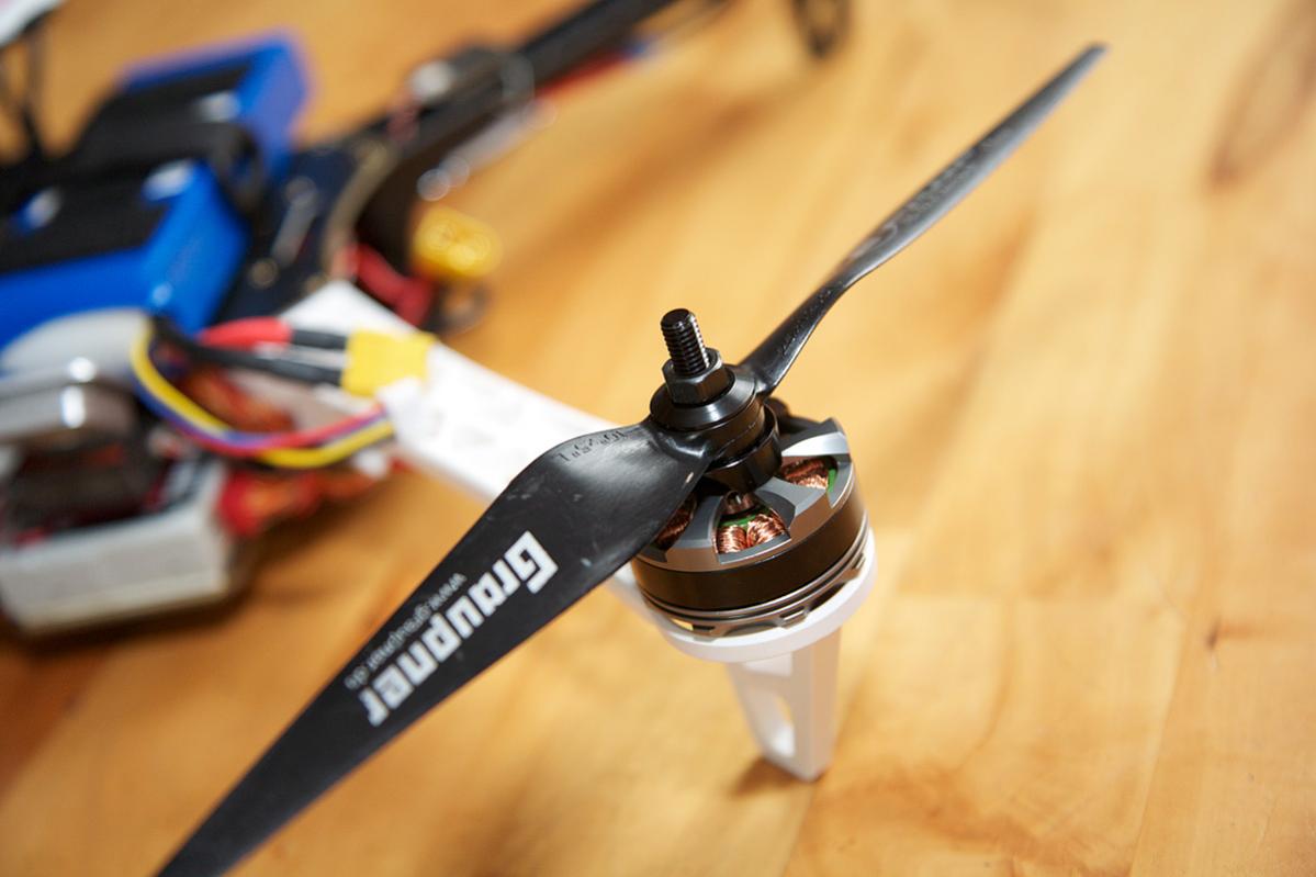

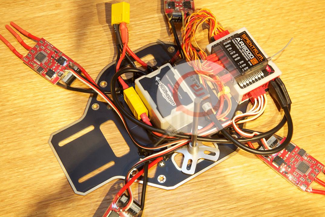

success! just had a first very quick flight with my wkm/flamewheel build.
when i first opened up the boxes, i thought a wkm in a flame wheel would be a crammed mess, but with a bit of thought it all fits 'mid deck' neatly, leaving a space at the front for a GoPro and room on the top for the Lipo.

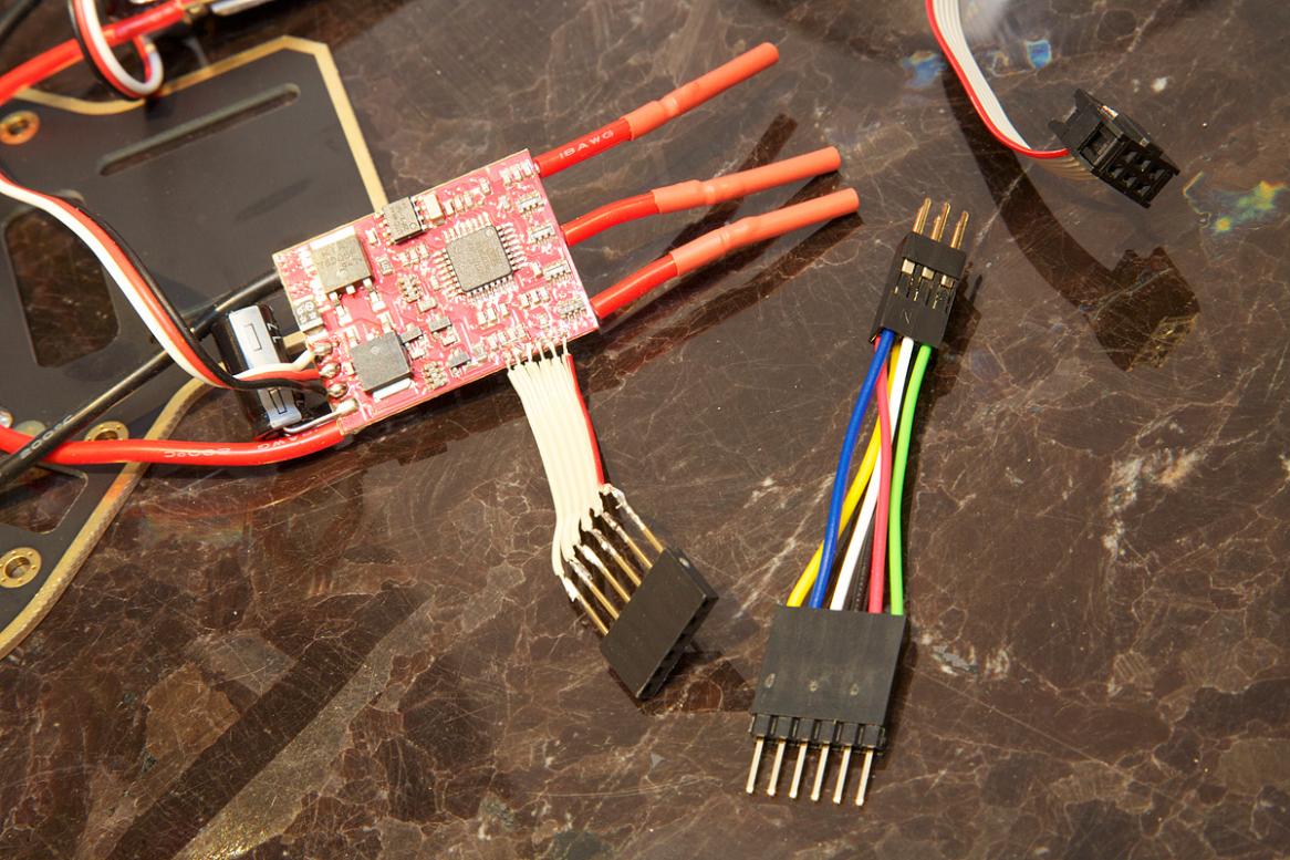

I flashed the plush 18A's (see pic of my diy connector)
Gunter very kindly sent me one of his LED mounts - which is just the job and is probably the missing bit from the wkm kit.
it's cold here today and for some reason the two charged lipo packs don't like it (or are less charged than i thought) so i managed just seconds of flight - but enough to know that this set-up is the best 'out of the box' i've tried so far.

does flashing the ESC's make a big difference, I was thinking of using plush ESC's on my F450/Naza due to low cost and plentiful availability within UK, but was'nt planning on flashing them. Kinda worried about messing up and not being able to revert to default. Does it increase the refresh rate? make a more stable or responsive machine?
Can I use them without flashing?

@bowley, when i compared them on the bench, the flashed esc's seem to have more resolution from min to max throttle and 'seem' to be more smooth.
plush esc's are fine out of the box and don't need to be flashed. if you do plan to flash in the future the esc's have to be the ones with atmel chips and NOT SiLab chips. most of the low cost esc's now use Silab chips.
