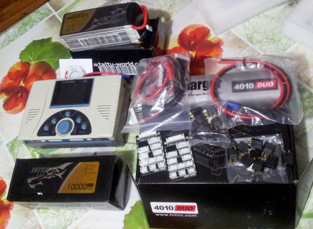

two Tattu 10000 6S 25C
iCharger 4010 duo
eFuel 1200watt power supply

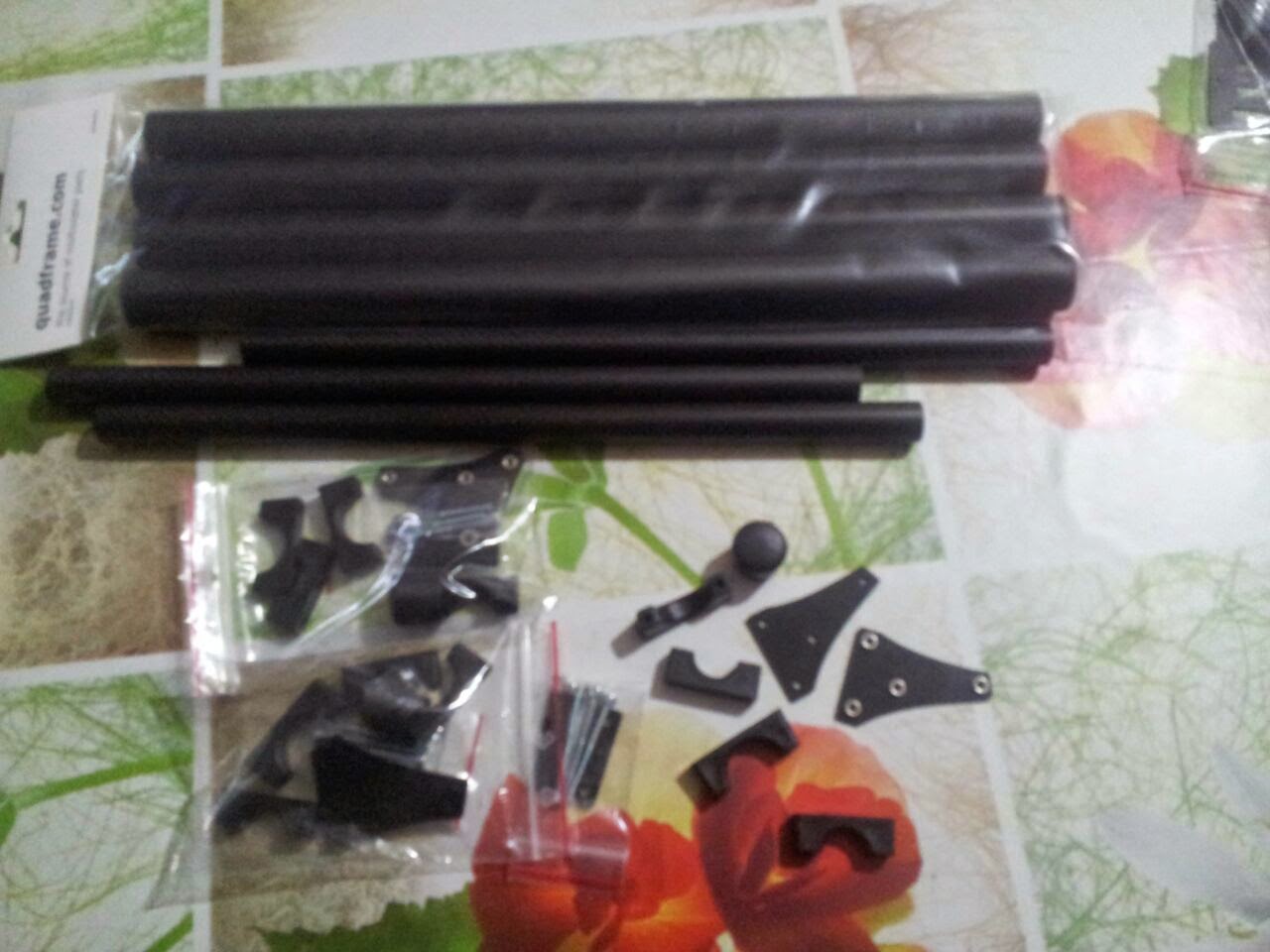

anaka

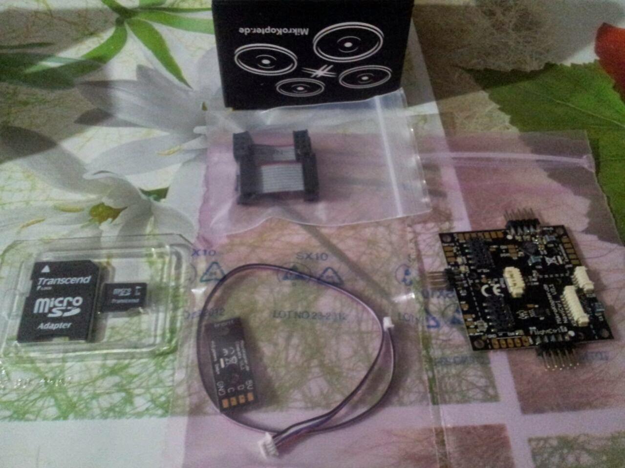

first elements arrived

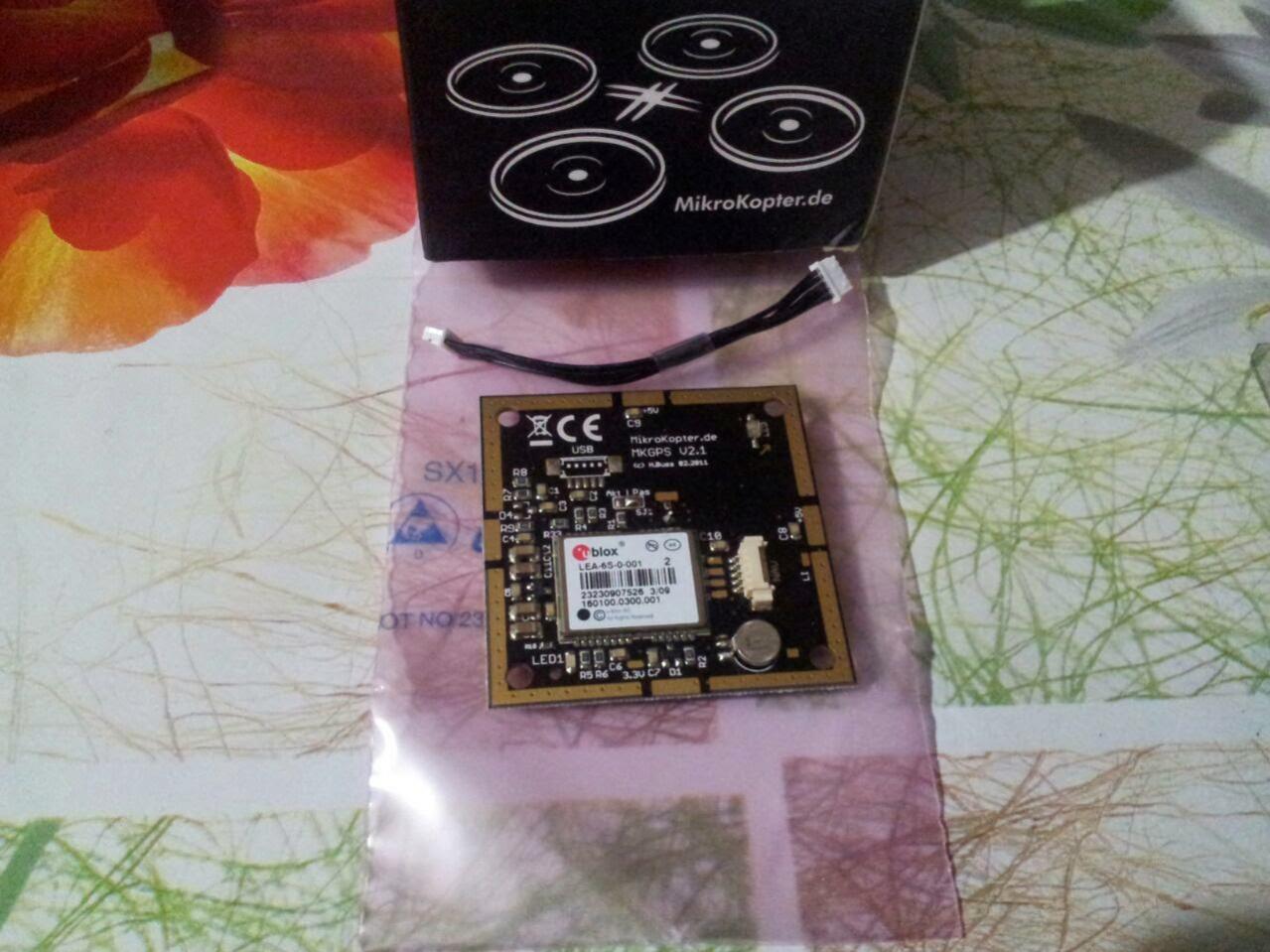

anaka
attachment.php
attachment.php
attachment.php
attachment.php
attachment.php

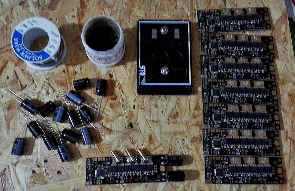

some electronics :)

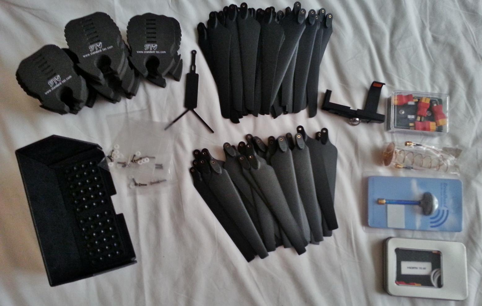

porpellers and other little tools
I chose STO and TAROT in the place of Dji
now that the list of components is complete I can move on assembling...

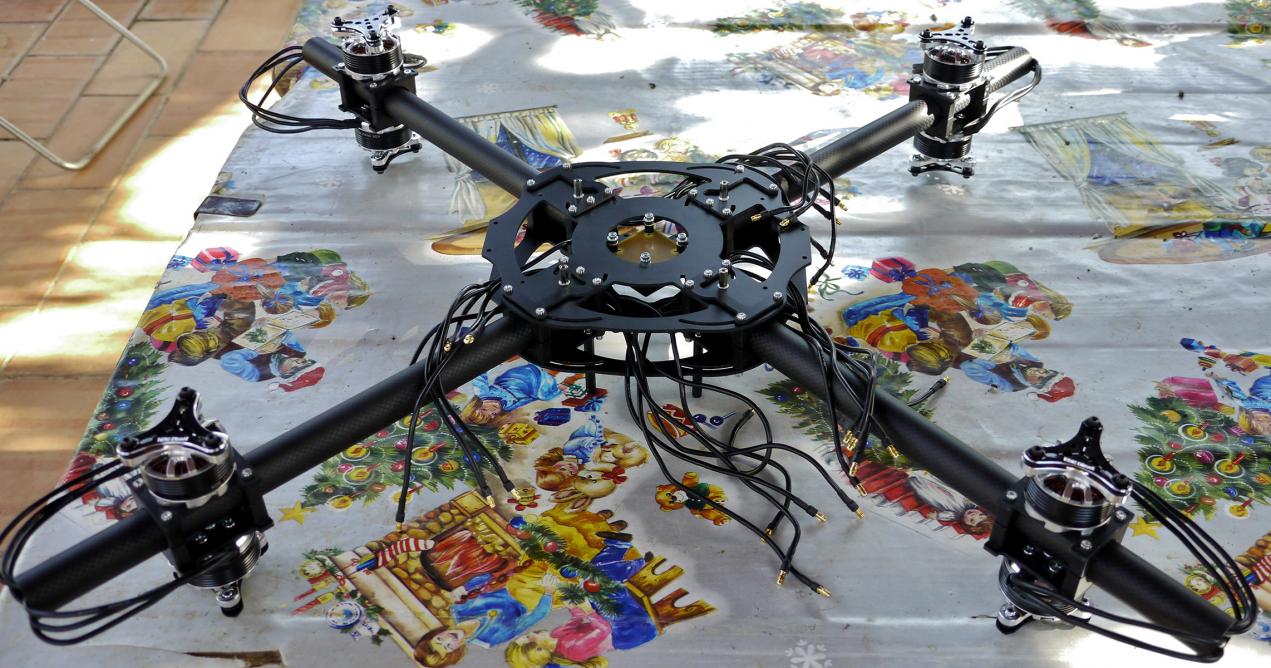

anaka

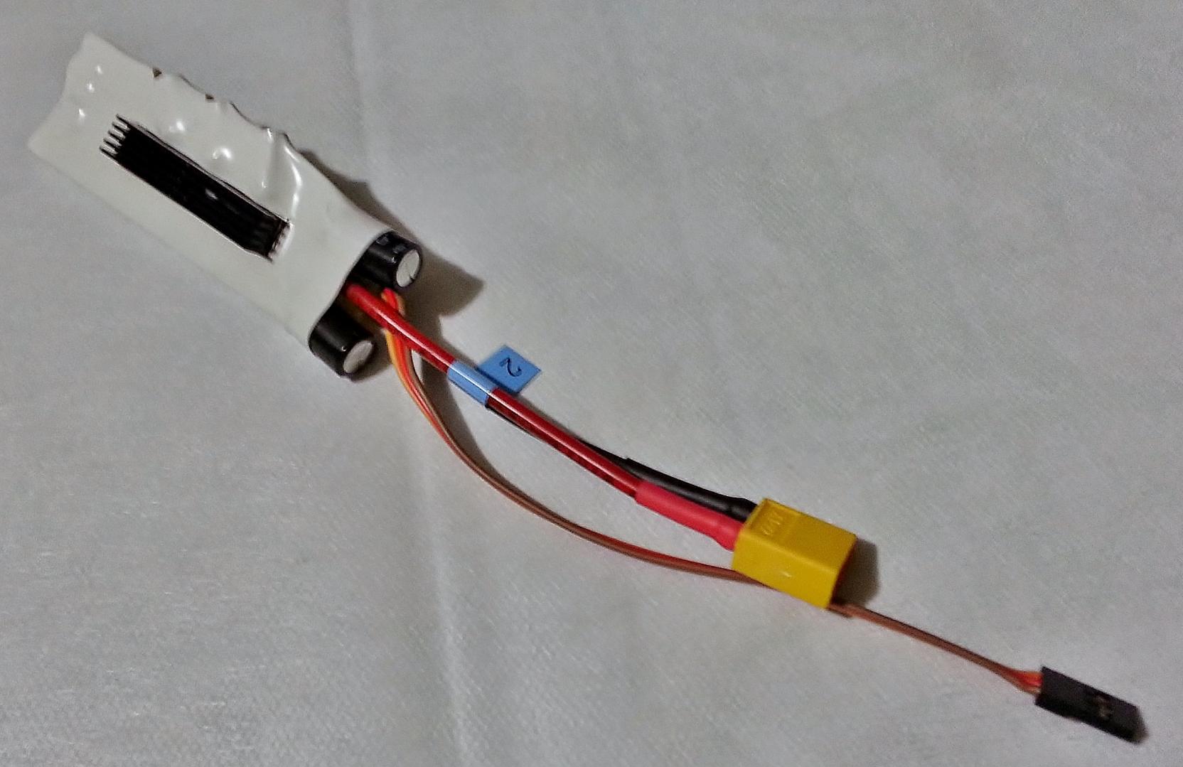

anaka
I did a personal version of MKBL v.3.0
they no more look like MK stuff but work and can handle KDE motors pretty well
anaka

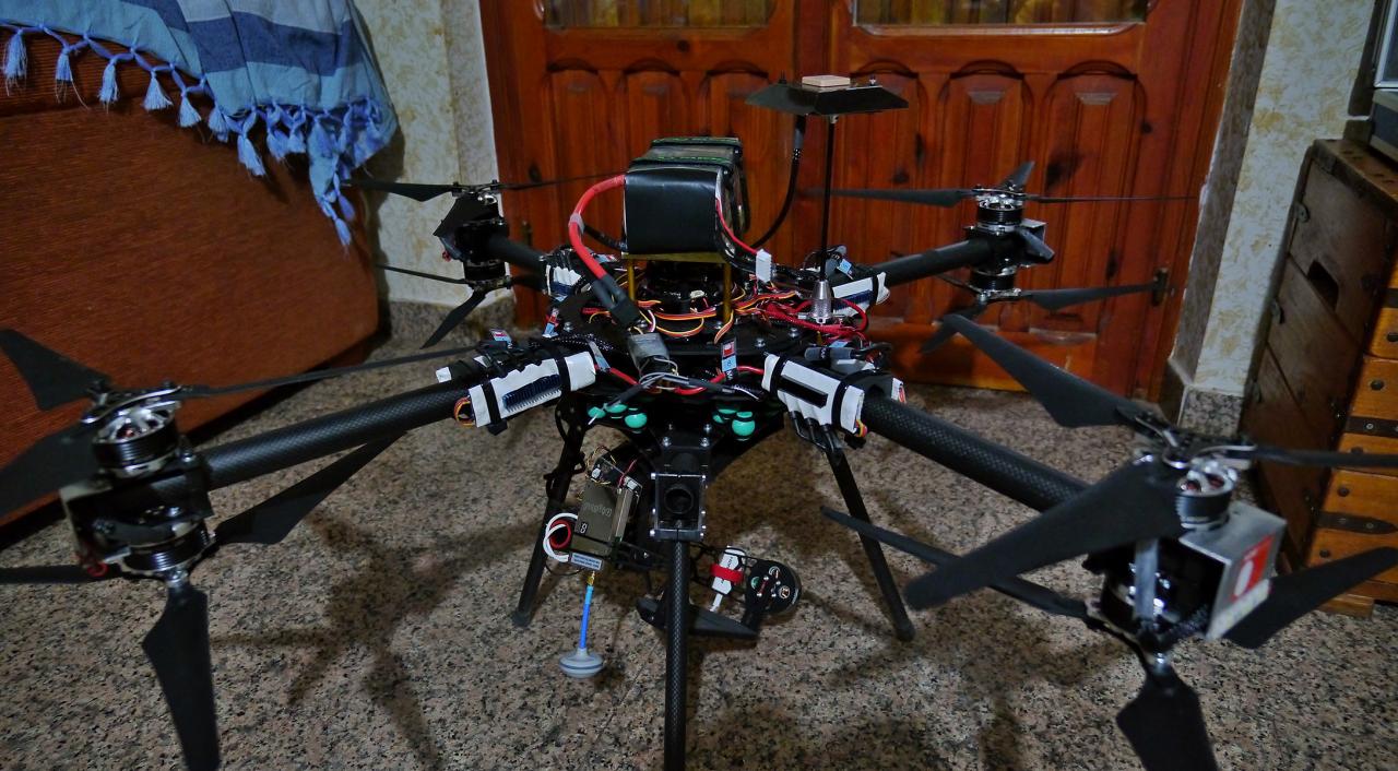

anaka
the first flights were good
the total weight is aroud 7Kg and with a Tattu 10000mAh 6S i have 10 minutes of flight time
the flight is smooth and stable
the three blades coaxial setup works well and has a big airflow...on each flight i produced a lot more dust than the usual
i'm still working on the gimbal and wireless video
hope to upload some good videos soon
