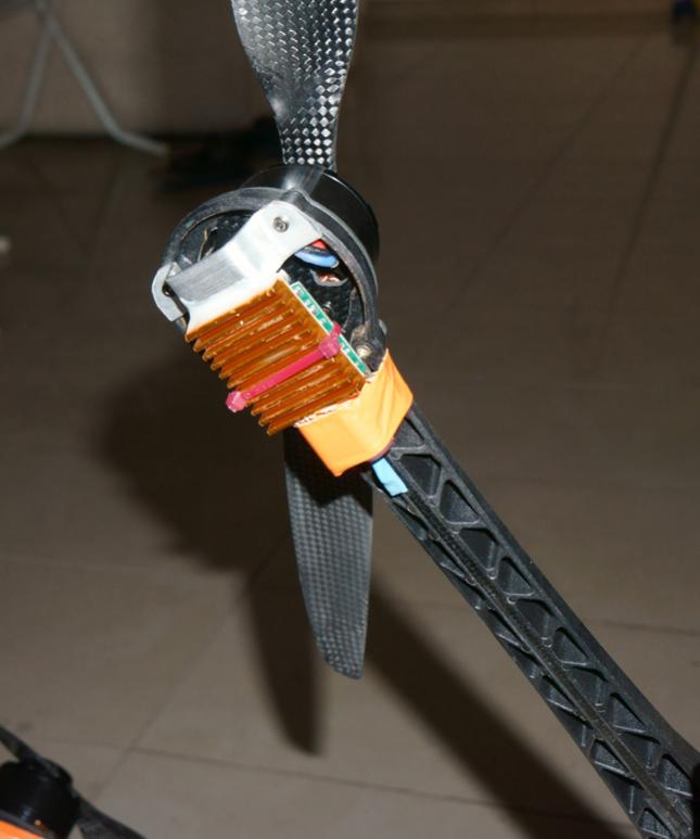

Today I flew the S800 with a set of Suppo motor 50 Amp. ESC's after DJI announced that they do not have a stock of new ones. It flew great. timing high - 30 Degrees plus all of the usual brake off etc. They were not even warm afterwards.:tennis: I do regard this as a temporary measure until the new stuff arrives. The S800 does fly really great even in high wind and the zen is just superb.:tennis:
DennyR
View attachment 5098this is before taping up to stop dust etc.
I am also making a small batch of APC prop adapters as I want to start using the 14x4.7 to see how it compares. If it is even close, that will do, just for the cost saving.

View attachment 6821this is before taping up to stop dust etc.
Denny, really nice solution for your temporary problem. Nice to know that it flies well. Let us know how the 14x4.7's work.
