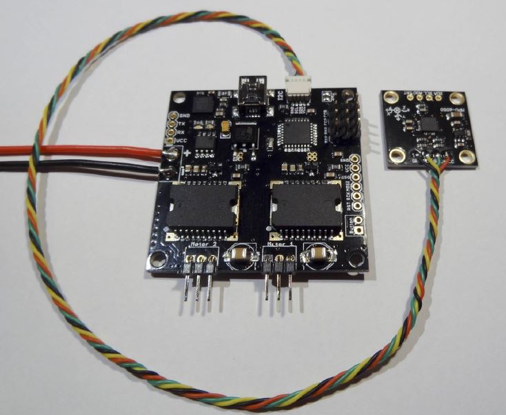

Connecting the IMU sensor board to the SimpleBGC controller board....... Some of the earlier units were shipped without IMU port connectors and the interfacing four wire cable. In such cases very fine soldering is required using an appropriate wire gauge that is not too heavy. I cut up an old IPhone USB cable which proved most suitable for the BGC/IMU connection as it is light gauge, stranded and rugged c/w Teflon or nylon insulation. The wire colors are red,green,black and white which is of no concern if one takes care to connect both ends appropriately as laid out in each pcb. Here is an example of a later release of the SimpleBGC c/w board mounted connector at one end and soldered connection at the opposite end. NOTE: If you receive one of these from a supplier you should note that in addition to the two LEDs on the BGC board, there is another on the IMU sensor board. If it does not light up when first connected to the SimpleBGC and powered.... then it is defective or wired incorrectly. I first bought and used the open source Martinez BGC board but it was a challenge to update the firmware and get it working properly..... now fully resolved. My next posting compares the Maetinez with the Alexmos....... View attachment 13104
