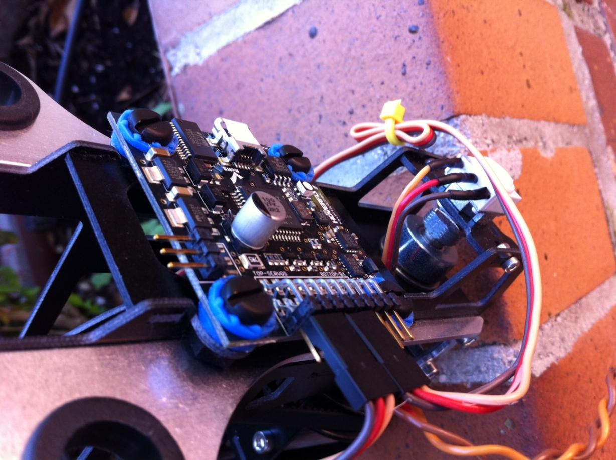

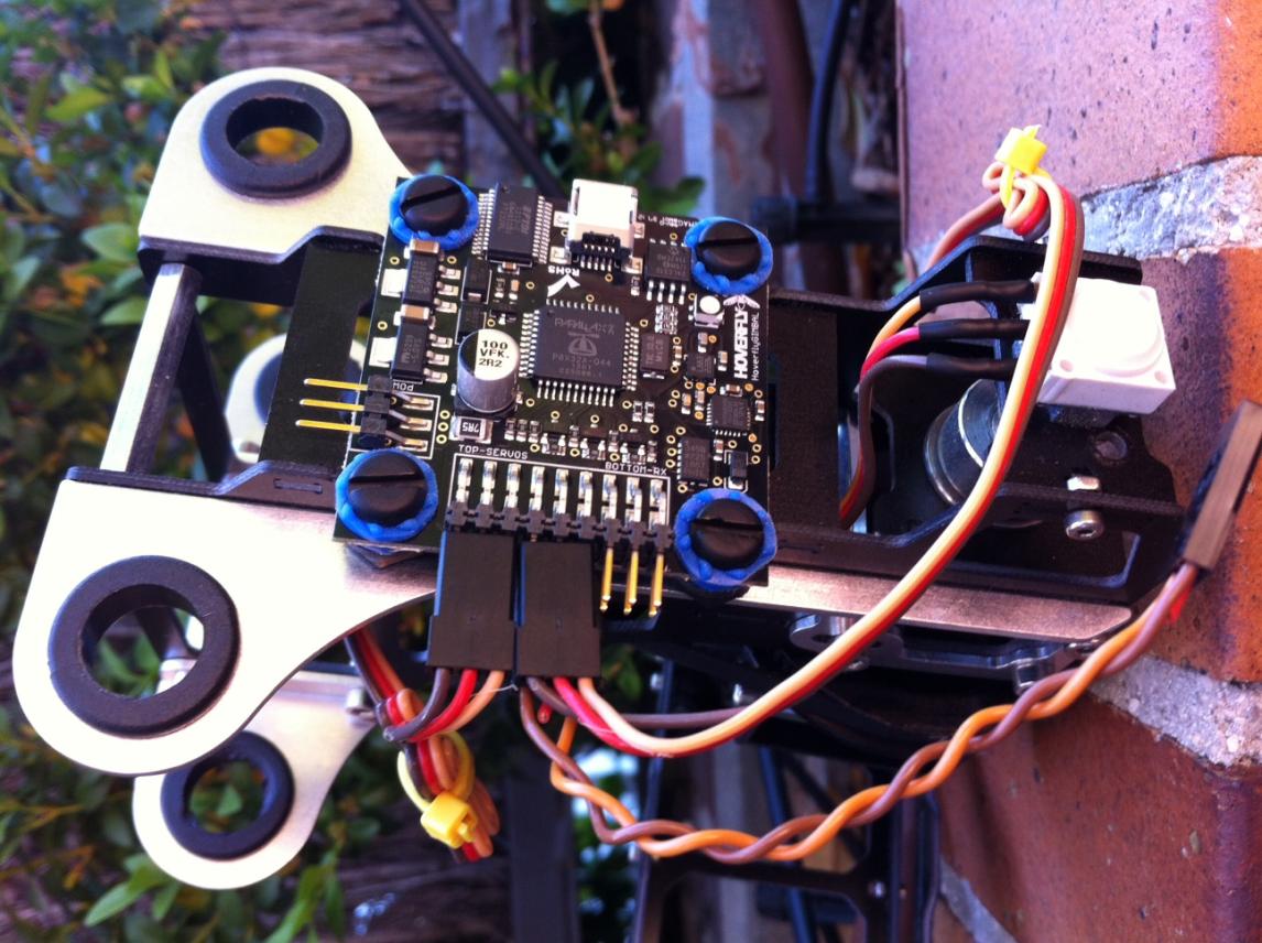

Hi Javier
Just ordered my hoverfly controller too been using the VTR from aeroxcraft on my heavylifter conversion f550 but now kinda of confuse on the installation process of the hoverfly board to it. So if you could help me on it I will appreciate it!
Regards

Hello Pedro.
Here I have a couple of photos from my Hoverfly Gimbal installation. I had to cut the screws in order to fit and don´t rub the back plate of the gimbal.
The three pins on the upper side are for the 6V from the CC BEC. On the left side you plug the two servos from the gimbal and I have an input from a spare channel from my receiver to control the tilt of the gimbal. Don´t forget to cut the RED cable from this connection so the gimbal does not receive power from it.
Sorry, the photos came rotated CCW 90º.
