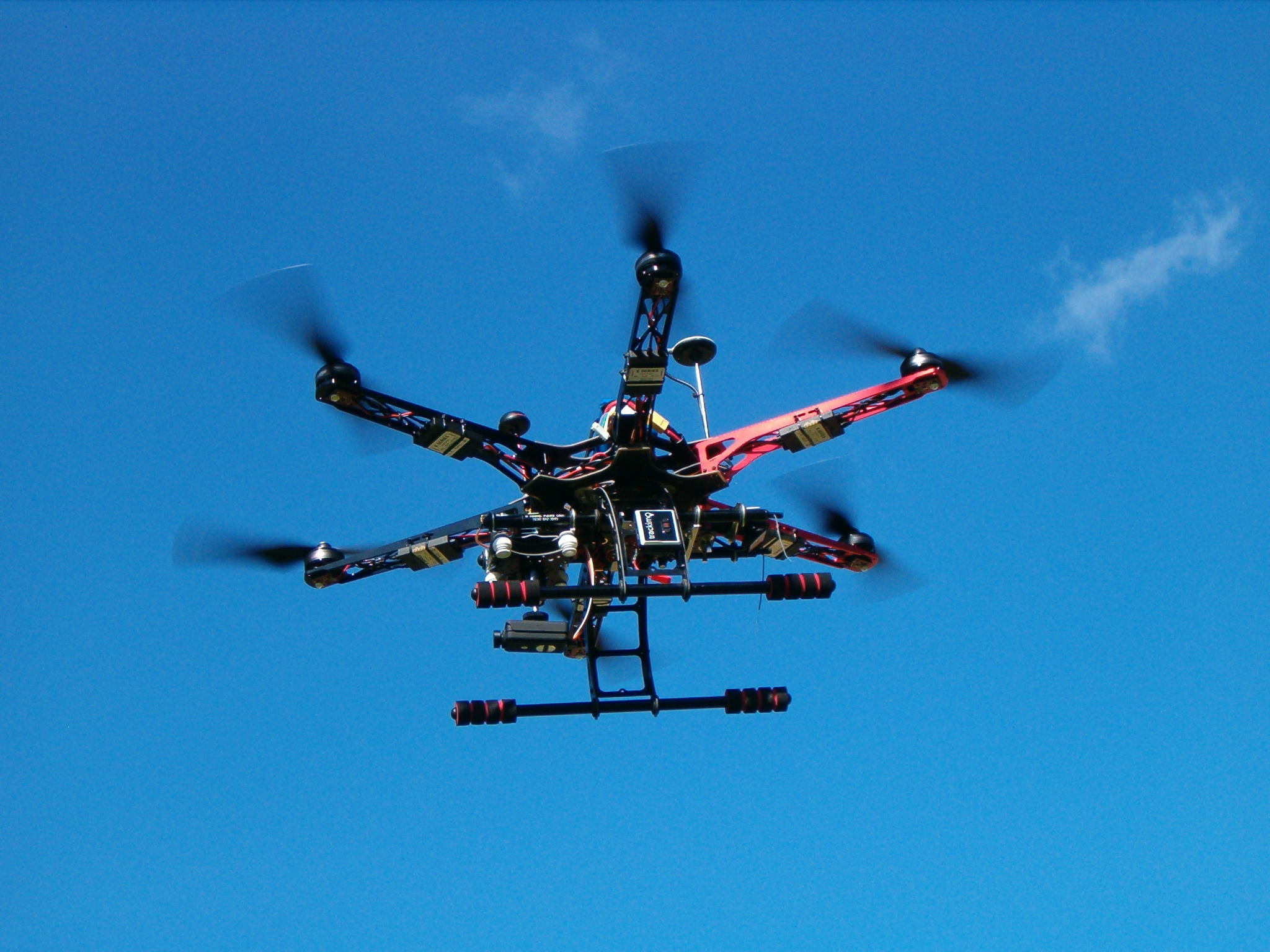

I am using the E600 motors with 12 in props on a 550 frame with Aeroxcraft extended aluminum arms. If you
can fit 12 in props- you are good to go. These motors have plenty of power and run cool. I know I had mentioned
13.5 props- but I double checked and they are the stock props (12 in) that ship with the E600 motors.
The copter pic shows a Mobius camera but was changed out for a Go Pro 3.
The one image is a basketball hanging underneath and the copter had no problem lifting it.
