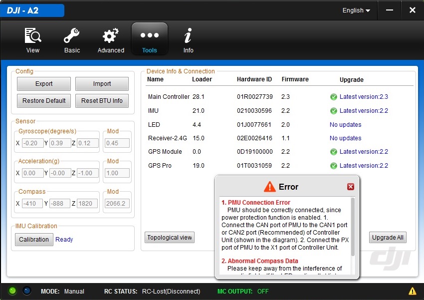

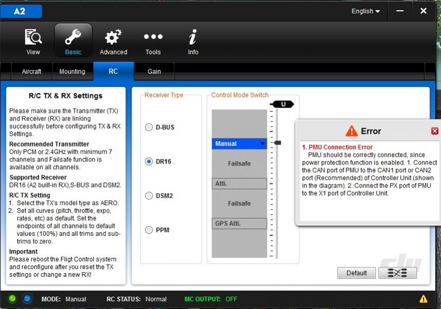

Tahoe Ed
Old Man,
You get the PMU error when you are not connected to your flight battery. You will always get the need for compass calibration when you do an upgrade. If that is all you got you are ok.
