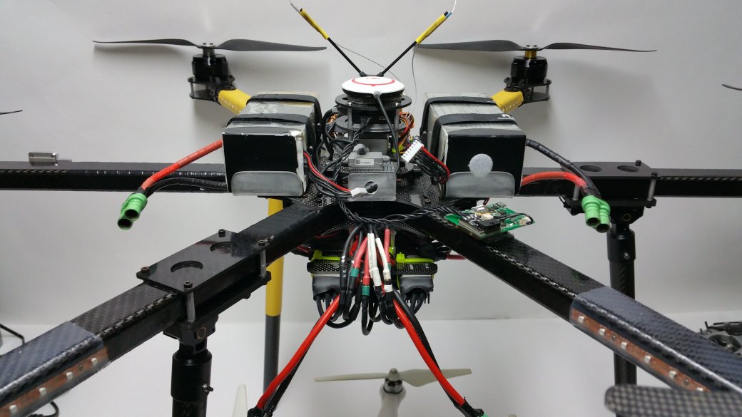

Thanks guys. I just wanted to make sure. After many awesome flights with amazing and tight gps hold I had a couple with major toilet bowl effect.
I was trying to think of what I changed of the rig that could have screwed up the gps. My conclusion is that I moved my rx antennas much closer to the gps as seen in this pic. When I moved them away the toilet bowl stopped. They antennas must be causing a disturbance. I'm gonna move the antennas permanently bit they are a little short. I think I will order the 400mm futaba ones and swap out the stock a2 antennas.View attachment 25904
be very careful when you open up the A2 to replace the antenna leads, they break off easily and will pull the underlying circuit board traces with them. steve tried it and ruined his A2
Pumpkinguy
I know all about sleepy's problem. I will play off his misfortune and proceed carefully. I will take my time and use heat if necessary.
I have replaced other dji antennas and none of them had adhesive inside the connector. I hope his was just an anomaly. Cheers.
