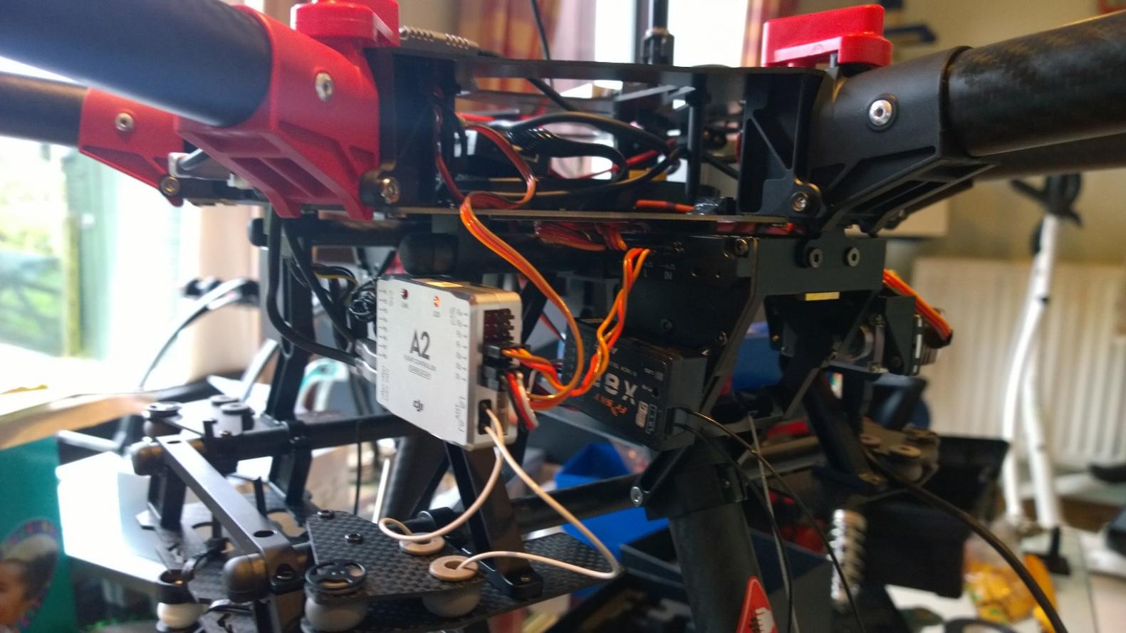

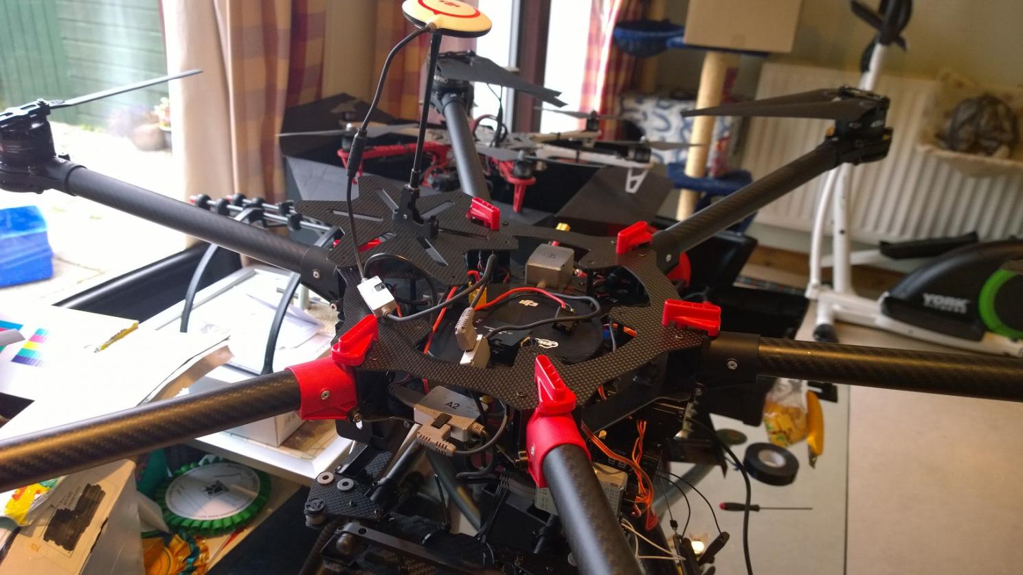

Hello, having some trouble with my A2 on the s900.
Once I power on with a 4s Lipo I get what sound like warning beeps from all motors with flashes from their LED's (never stops). On my other Heli's this usually means they can't find the flight controller.

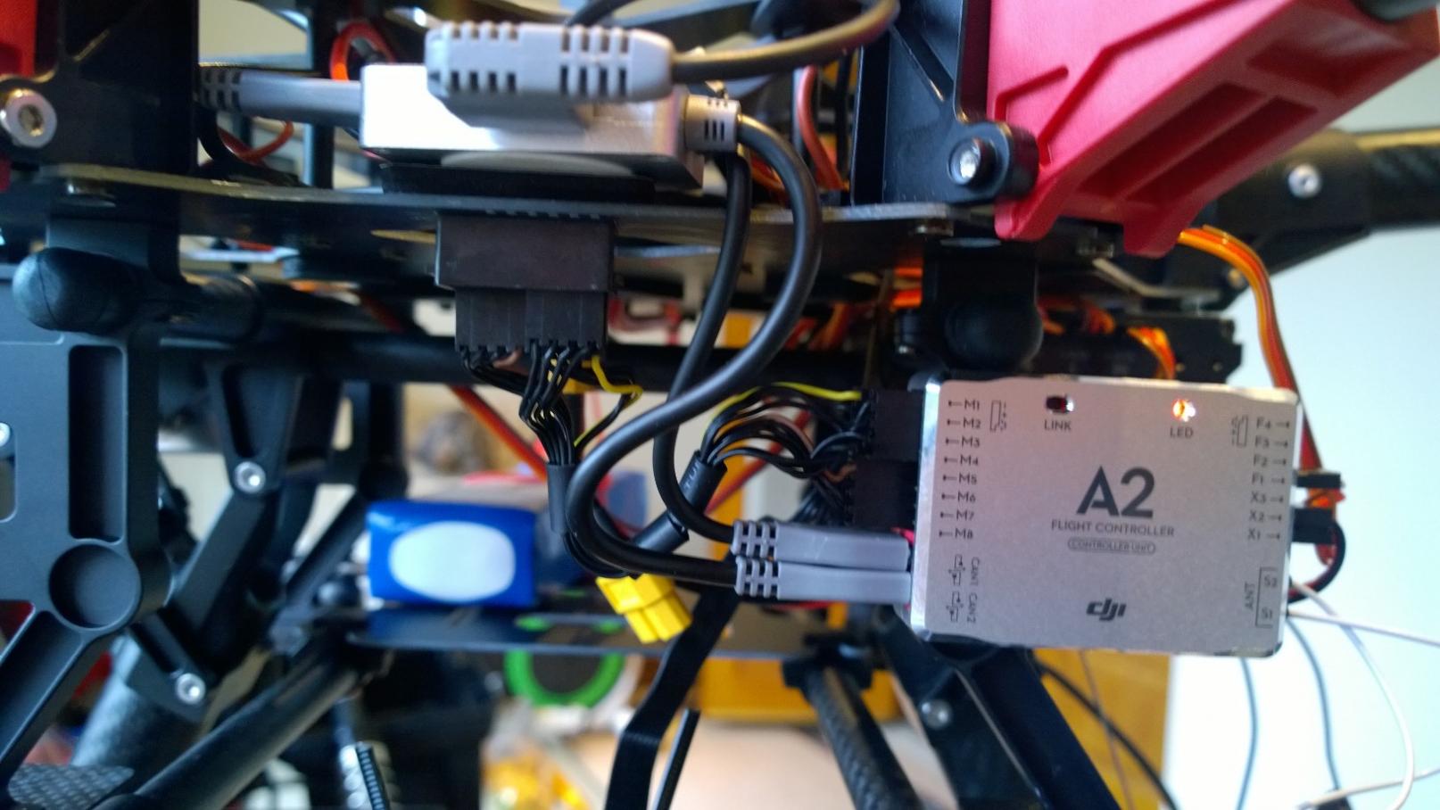

I've triple checked my A2 connections from the centre board, the yellow is going into the first 4 pins of the A2 and into the corresponding pins on the board. They are the furthest away pins in both cases.
Using D-BUS on an X8R, everything looks configured in the Assistant, calibrated IMU and my Sticks to near 0 except throttle. I can get ful range on the Taranis, motor test doesn't spin up the motors, so it's like they aren't seeing the A2. Tried replacement cables from board to A2. Only one way to plug each motor into board.
Anything I can try? Attached a short video and some images in case they help.

I imagine it's a low voltage warning because you are trying to use a 4S lipo! Try the recommended 6S one and see what happens.
