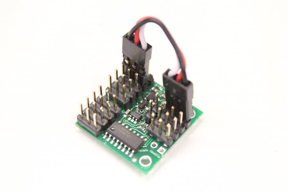

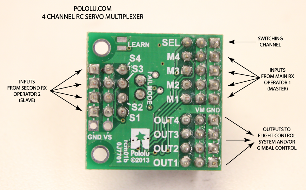

The module used is from Pololu.com, it's a 4 Channel RC Servo Multiplexer
http://www.pololu.com/product/2806
View attachment 22407 View attachment 22408 View attachment 22410

Bart this is fantastic, absolutely perfect for my needs, have managed to find a UK website that stocks this switch and just made the order. Very excited to receive this now :D.
apsussex
Hi Bart, received my multiplexer yesterday and have soldered up all the pins. Only pan and tilt are required as I want to keep the master with control of the shutter and modes.
I havent connected to the receivers yet, but will post up photos once its done. Your video was very helpful and I did notice you need to use the training mode for switching between outputs. Is this a fairly simple operation once everything is connected?

OK this is all good, as it turns out I didnt need to use the learn function, it just seemed to work. I had the Futaba 14SG setup using switch SD (channel 8 on my setup) which is to switch between output channels..
I may update the controller at a later date, but for now coming in at about £65 delivered for a second controller/receiver/switch and a bit of spare time, I have the option to use a second controller for the gimbal at just the flick of a switch.
brief video of it working here... very happy!!

Because Both are sbus single lead out put, I wonder if I need to go with non sbus rx's to make this work? I do have a Futaba sbe-1 converter as well.
can't you put a futaba receiver in there and just run discreet channels instead of sbus?

Hey Bart,
Got this fitted and test flown today. Your tutorial was spot on - only took me about an hour to fit including making the servo cables.
Did have to enable the inversion but easy enough done following section 9.3 of this doc:
https://www.pololu.com/docs/pdf/0J60/pololu_rc_switch.pdf
Did a few test flights this afternoon with brilliant results. Put a load of expo and dual rates into the second tx to get nice smooth yaw/pan movements.
Only thing I haven't sussed out, and I'm hoping its due to lack of time playing with it, is the failsafe. Was hoping that if I didn't use a 2nd tx then the failsafe on the pololu board would automatically give me control of yaw and camera tilt to the master tx no matter what position the IOC switch was in. I'm thinking this could be due to the 2nd rx giving it a failsafe command. Have you had any luck with this?
Henry,
We designed that into the system that we were developing (the red board in the video) where the absence of a second signal would keep it tuned into the first but the Pololu doesn't have that. The red board also had a signal test where it wouldn't switch if the signal was there but unusable.
To disable the Pololu system just unplug the servo connector for the switching channel and it will only use the master outputs (single operator mode)
