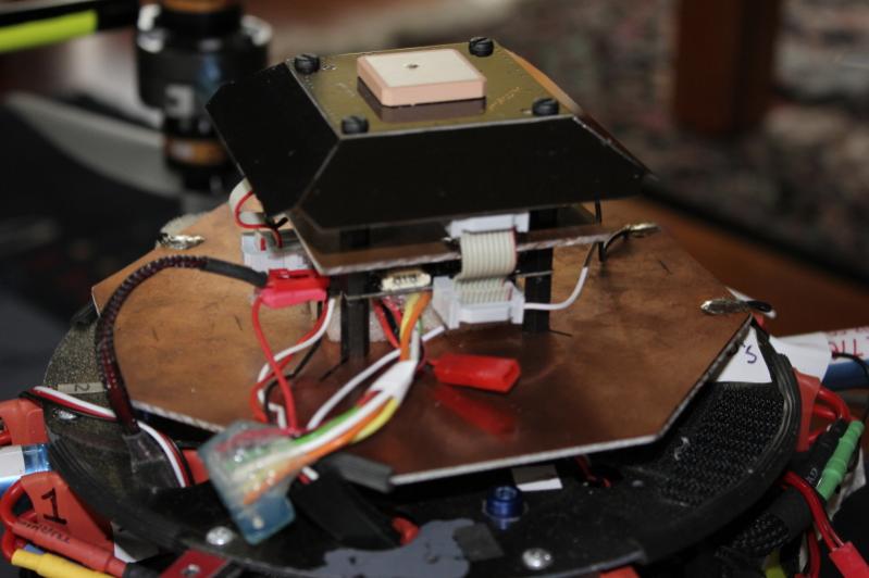

I am a total newbie to multi-rotors and as you'll see in a second, I am no electric engineer either... so please bear with me here... I do understand how the copper clad PCB board that can help, but do I need a 2-sided PCB board or one sided? Will a 2-sided board not cause a short? Would you mind posting a picture of how you installed the boards and where you installed them please for the less electrically-fortunate folks like me please? :) Thanks in advance!
crcr
Sorry for that delay.
You can see I have a big board under the FC and also one between the FC and Navi. The bottom one probably doesn't need to be that big but when I was testing I wanted the biggest I could fit under the cap, then just left it there.
Cheers,
Craig
FOX222
The problem with the magnetometer (compass) on the navi board is due to electromagnetic field not emi/rfi. This em field is usually caused by long and looped power leads feeding the esc's and battery. The best way to fight emf in our application is to not create them to start with. One way to do this is to get rid of as much power wiring as possible.
The copper clad board is totally transparent to emf and would be better used as a power distribution board. By using a double sided copper clad board and making the top side negative and the bottom positive you can do away with a lot of looped wires that generate emf. Then you could cut your power wires on your esc's as short as possible and solder them to the power board at each arm of your frame so as to feed out to the motors. This will eliminate a large part of the emf radiation and negate the need for a shield.
You might want to read some of the articles on the wed about magnet shielding. The only way to help block a magnetic field is to reroute the field by using a material with high magnetic permeability. This is a good read for understanding the basics of redirecting the magnetic field. http://www.physlink.com/education/askexperts/ae512.cfm but all this is pointless if you don't create the emf to start with.
