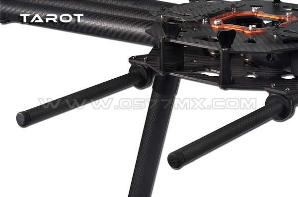

I have a Tarot T810 and the Tarot Gimbal Mount (the carbon fiber rods).
http://www.tarot-rc.com/index.php?main_page=product_info&cPath=65_97&products_id=1007
Most gimbals simply snap onto it using 4 'C hooks' (no idea what they are called) like on the top of this gimbal:
My H3-3D doesn't have anything like that, or can i find parts to attach to it. So just how are people installing their H3-3D when not in use on a phantom???
I'm not talking about zipties or custom made CNC plates... Just something normal that every other gimbal seem to come with, except DJI H3-3D...
If it's not possible/recommended, then what gimbal do i get for a Hero3+ Black Edition that's just as good as the H3-3D?

Probably late and this camera now lives on a P2, but i originally mounted it to a carbon plate and mounted that on the tarot gimbal rail system. Worked great.

They are called "Load Hangers"...
You can buy them in this kit, with the necessary plate to attach the H3-3D, but they're different spacings I think than the Tarot...
http://www.helipal.com/camera-position-kit-660mm.html
