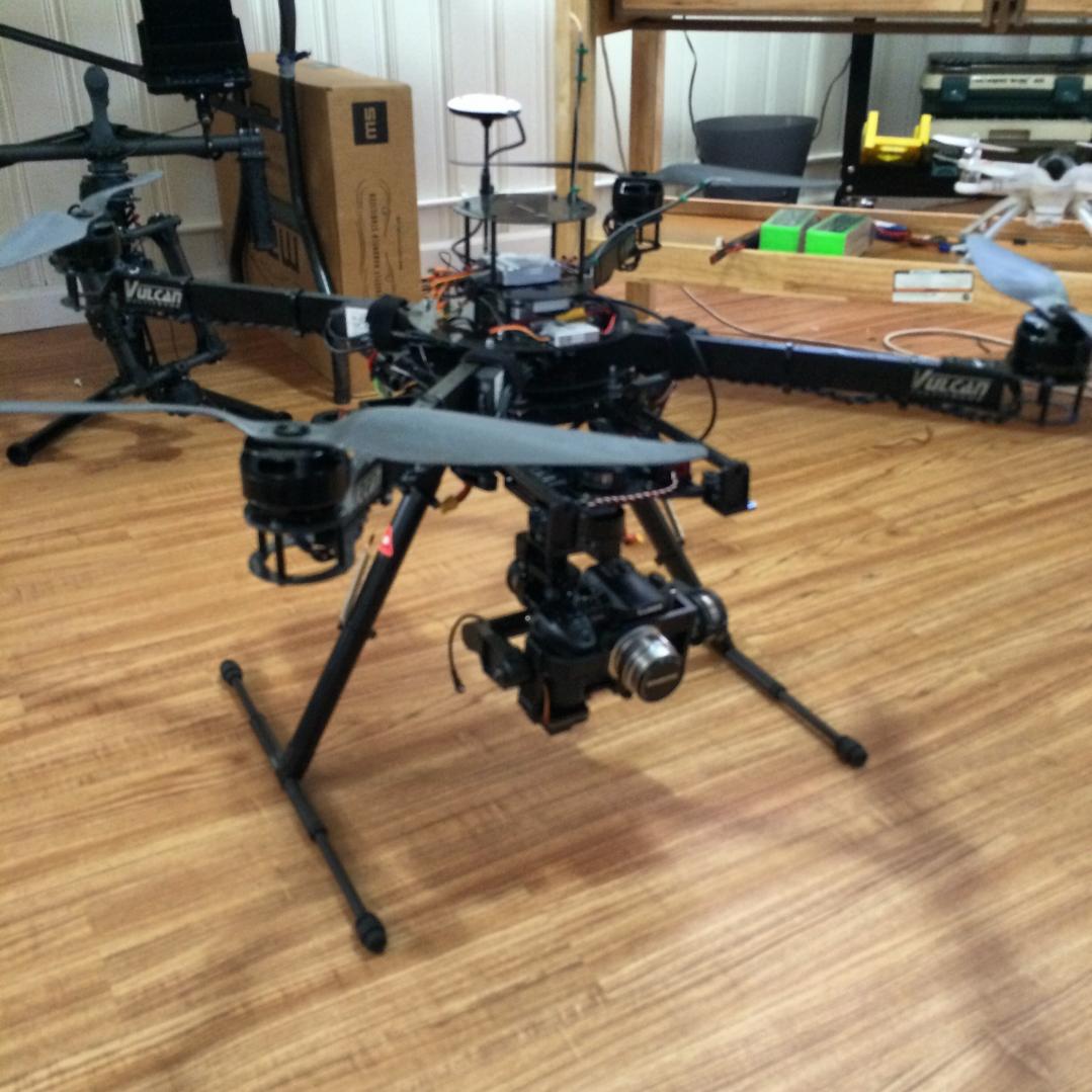

I hear ya, I'm a BIG quad guy. I love em.
My newest has a lift capacity of 20 - 28 lbs can fly for 14 min,
is only 800mm and swings 18" props... I love it! And I hear the "redundancy" argument all the time.. but meanwhile I've had 300= flights on my other commercial big quad with no issues. Maintenance, and it's no riskier than a octo or hex. cause if you take into account 2x the connections 2 x the equip to fail.. the odds even out. (in my opinion of course)

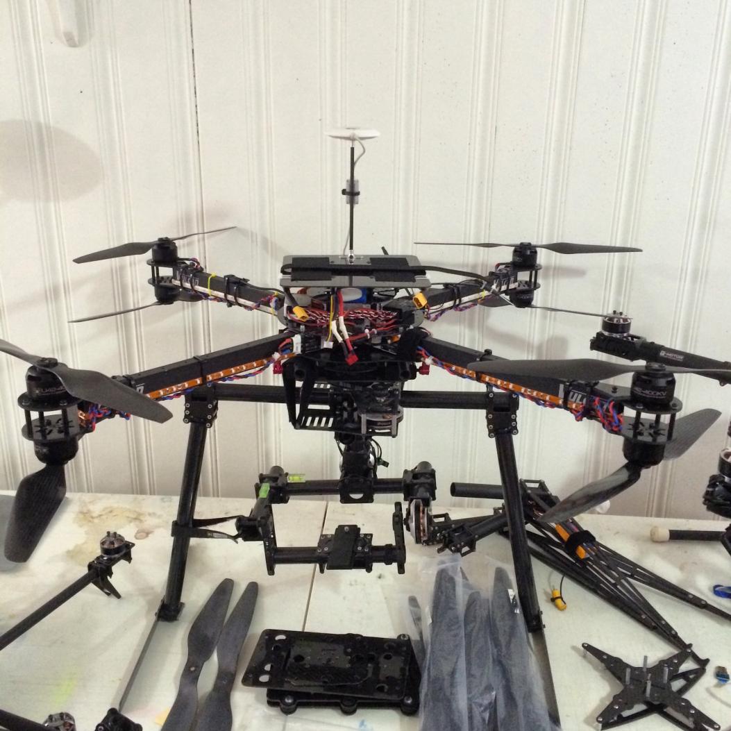

KDE's rock. I have them (380KV) on my other big quad swinging 18" props.
On this guy it's a Zenmuse GH3 with the [FONT=arial, sans-serif]OLYMPUS M.ZUIKO DIGITAL ED 12mm f2.0. I have the T-Motor U7's with the T-Motor 80 amp sec's on here.
They run hot, but I am told this is normal, and that the ESC's have a heat sink built in. The rig is on an A2 and is VERY smooth (so far)
I also have a X8 running a super X, FLYS great!' I'm testing some U5 clones with T-motor 45amp ESC's on that ones with 15/5 on the top and 16/5 on the bottom.
