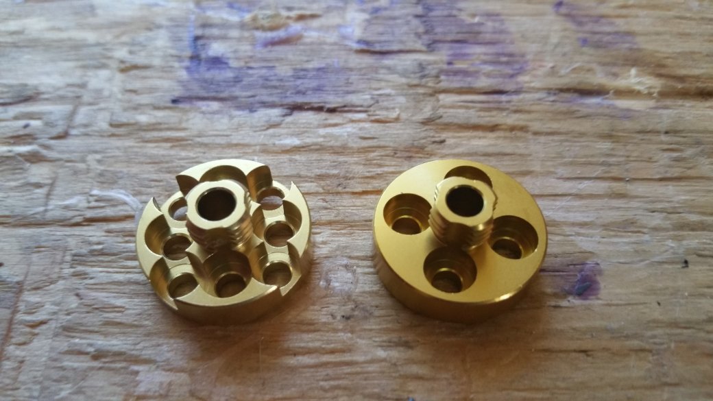

To update this thread.
The drones vision and foxtech came from the same unknown maker. The old design is now sold out and it has been replaced with the newer version. I ordered some because I needed more "top halfs" the side that goes on the prop. Even with the extra holes it is still very beefy. The bottom half on the other hand looks like there is nothing left. I'm sure they are fine but I just dont like the look of them. View attachment 25784
