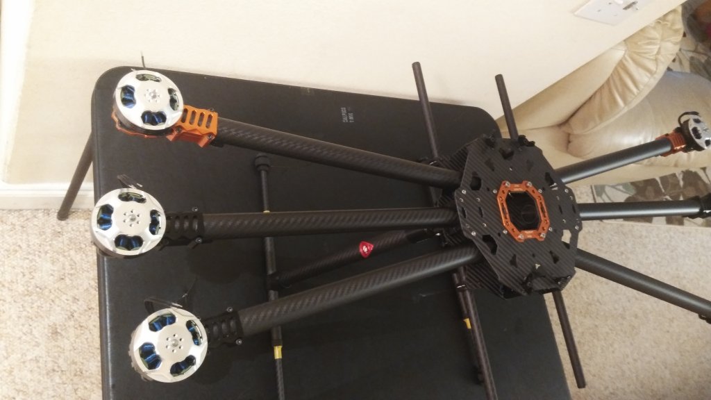

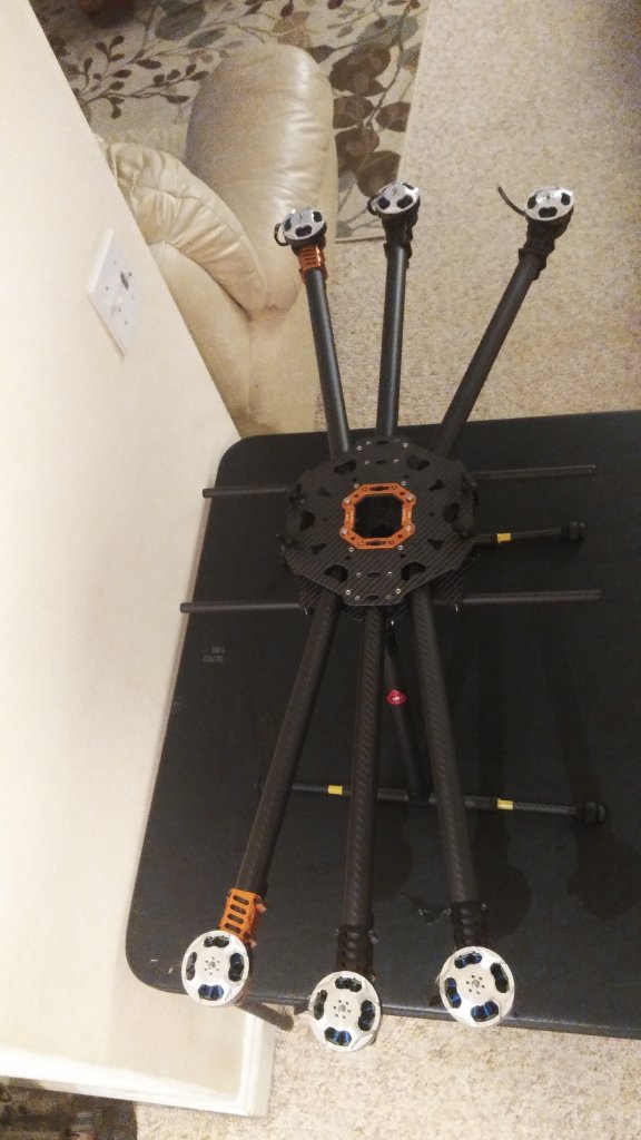

This is the Tarot T960 I'm working on. I will post photos of the quadcopter I took apart and am rebuilding. I used a totally different approach this time. No screws, just a lot of resin epoxy.

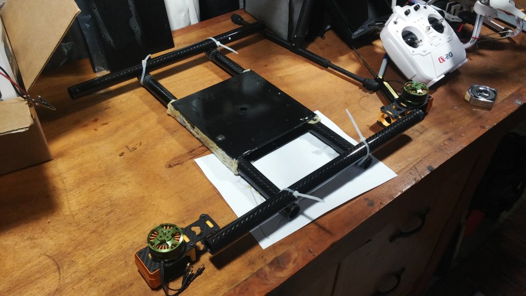

This is what is left of my homemade drone project. I am doing a different approach. Only four screws will be used. I have used resin epoxy and Gorilla Glue to hold the frame together. I'm going to drill a couple of holes and use zip ties as well.
