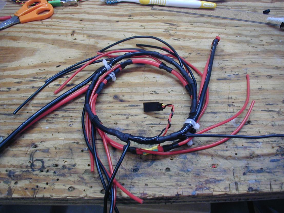

You've got to build a circuit for the power to go from the batteries to the individual ESC's. It starts with two loops, one positive and one negative. Someone commented that the negative loop shouldn't be a closed loop so it doesn't hurt anything to incorporate that detail into the layout. The loops should be large enough to go around the outside of the flight electronics. If you're using one battery pack then you need to also incorporate one set of battery leads into your loops. The loops for a quad should probably be 12 or 14 guage wire with individual 16 guage branches going to the esc's. I used 10 AWG for the loops and 16 AWG to the motors for an Okto heavy lift with two sets of battery leads powering the whole shebang.
To tie the branches into the loops just bare about an inch of wire, tin it, and then solder the branch wire onto the surface of the heavier loop wire.
Maybe the DJI doesn't require a power distribution loop like this?
Hope that helps.
Bart
Bart, thankyou for that...I guess it will have to be something like your loop design...it is relatively easy to put together and I can build it to an exact fit...it also isn't that far removed from pre-manufactured power distribution boards from..eg...MK, ArduCopter, etc.. The Wookong-W kit arrives tomorrow...maybe there will be something in print in the package that discusses power distribution.
